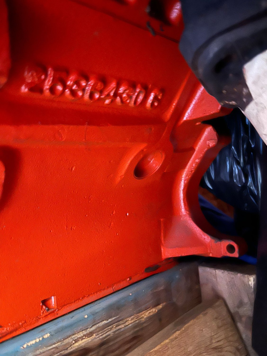

Hey guys, new here, and pretty new to the mopar scene, local guy is selling a “rebuilt “ 440 from his uncles estate along with various 70’ superbee parts. Looking for some help with the engine numbers . Apologies for the crap pics, it was a garage sale lol. Any help from the gurus is more than welcome. Thanks guys!

2536430 numbers are for a 440 RB 1966-72

You need the numbers on the flat pad next to the distributor hold down clamp.
sand or scrape the paint off and give us the numbers you see there, a picture would be better…
