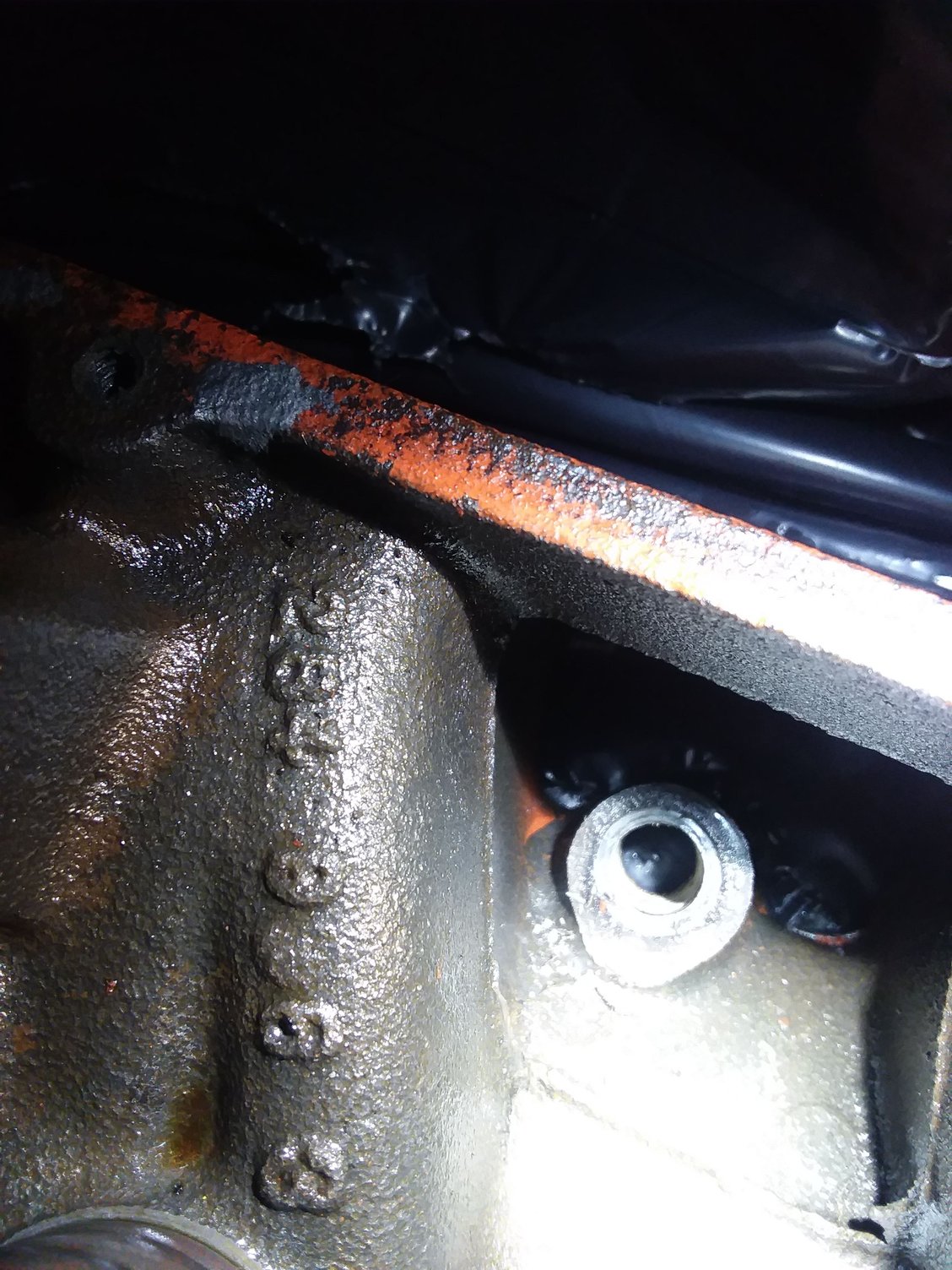

Need help with Vin and engine decoding
Any help is appreciated! The previous owner said it was a 72' truck but It has dual headlights and I didn't think a 72 had them.

Block was cast in 7/6 of 1988 and it is a 440 casting number.
7/5/1988,

That does not make any sense. Because the last year of it was 78-79 right?

I looked at the date closer and I can't tell if it's a 1988, 86 or 66 but the 6430 block is supposed to be a late block.

What would the .5 mean? Like a mid year

Month/may got it?

7/5/1966
Night time
3:00 PM
Thats how I read it..
Old Dec 5, 2017 | 06:42 PM
Posts: 11,106
Casting number was used 1966-1672
7/5/1966
Night time
3:00 PM

Thanks y all. I didn't know where to start. And I believe this truck was pieced toget her but I do appreciate it.
