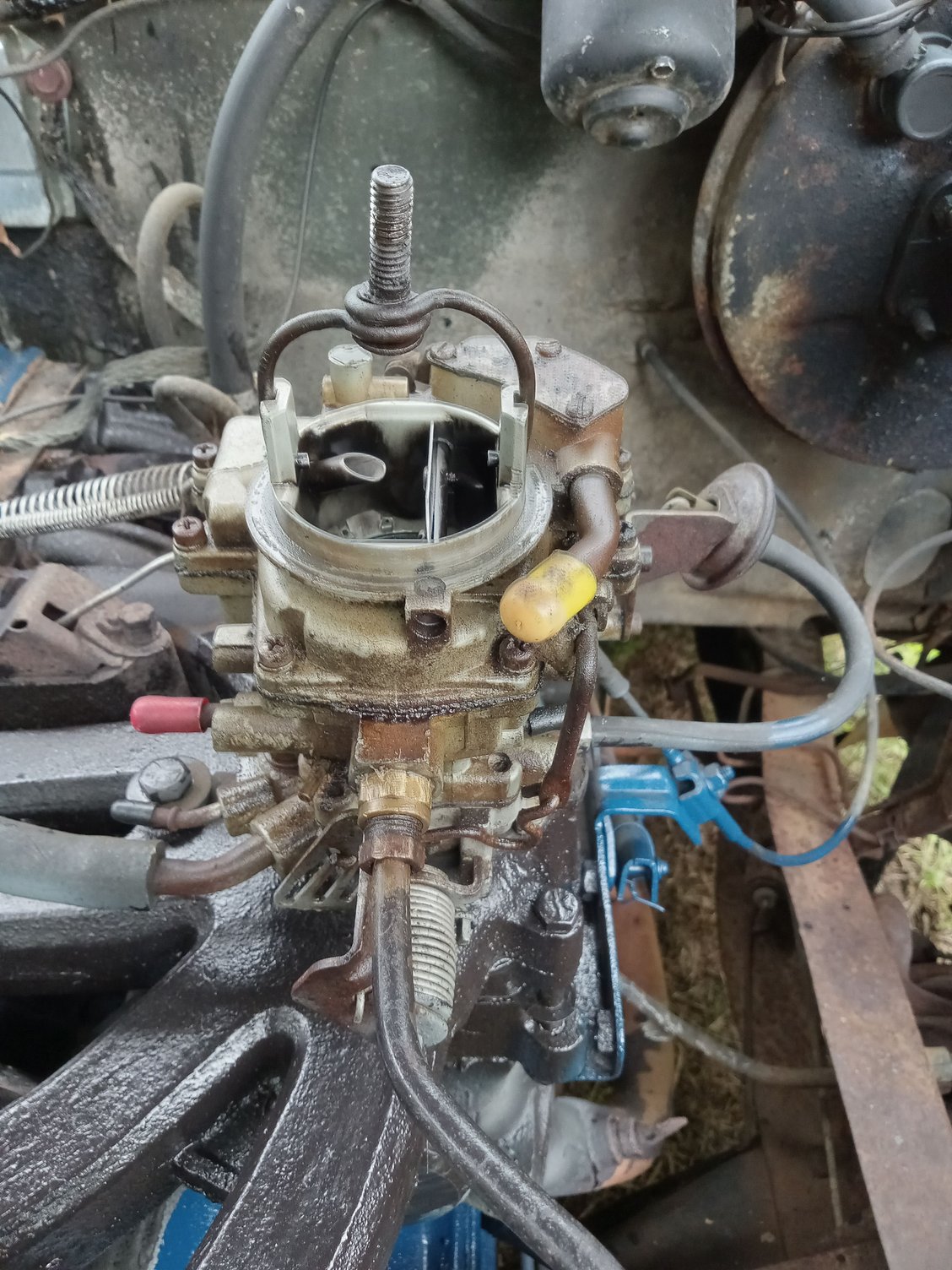

which carburetor is this so I can rebuild it. My first mopar project. Thanks

looks like the holley to me

That is a Holley Carb. Tip......the solid floats on those would get gas logged and sink. The factory accelerator pump also reacted poorly with gas and would distort and not work. The brass floats were good.
