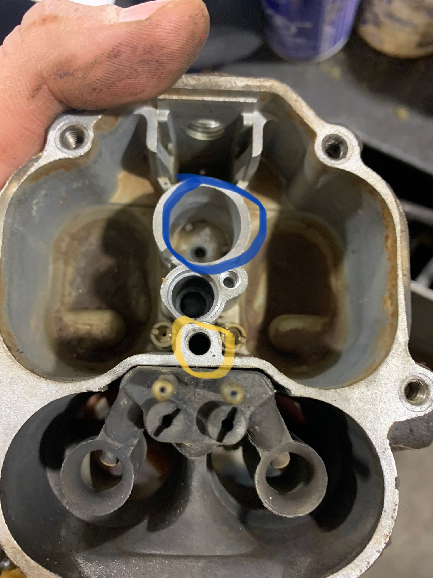

Hey guys, I’m currently rebuilding my 4419S BBD Carter Carburetor and as I was taking it apart, when I removed the accelerator pump, one of the check ***** (bigger one) fell out of the carb when I turned it upside down. Do you guys know by the picture of it goes in the blue area or the yellow? The blue is below the accelerator pump and the yellow is just an open port where no screws go.

I'm Not 100% sure.... I think the Yellow Hole is for the Air Cleaner Stud..... Blue hole takes the Smaller Ball..... The hole unmarked takes the Larger Ball..... Hope I an correct....
Double check in the carb kit Diagram ....

Ya im not 100% sure. The smaller ball wasn't in either of those because i found it in another spot as i continued to pull the carb apart. the bigger ball was the only one that fell out once i turned the carb over and i wasn't able to see where it was.

Going to have to find a break down... >>>>> https://carbkitsource.com/kits/ck0021.html

Here we go....
https://www.carburetion.com/diags/diagimg/C2-BBD.jpg

I’ve been looking forever to find that! Thanks so much. Do you by chance know if the site you found that on has the descriptions to the numbers in the diagram?

Never mind, I found it. Thanks again
