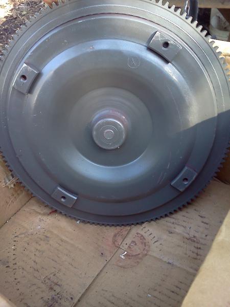

Old Oct 22, 2012 | 04:11 PM
Gorts 5th's Avatar
Joined: May 2012
Posts: 1,380
Likes: 103
From: Debary Florida
Smile
is the engine electronically controlled or old school
one way to save money is too do most the work yourself have the shop do the machine work you do the assembly work
my motor still cost me 1800 parts and machine work heads and such my motor was solid we just honed it and rebuilt it low mileage roller la motor
that's up to the left
the work u want done is this just buy ing a remanufactured motor or having yours rebuilt are u keeping it stock or are you modifying it
the mounts should work fine just get new rubbers for the 318 make sure the motor has mounts attached to it there may be some difference but if he didn't modify the k member mounts your 318 will go right in just change the tork converter
