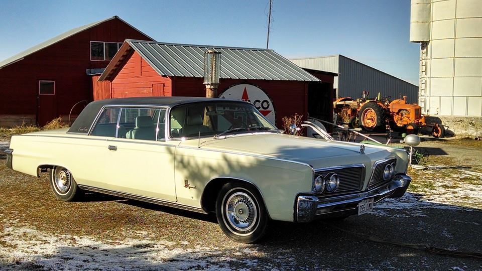

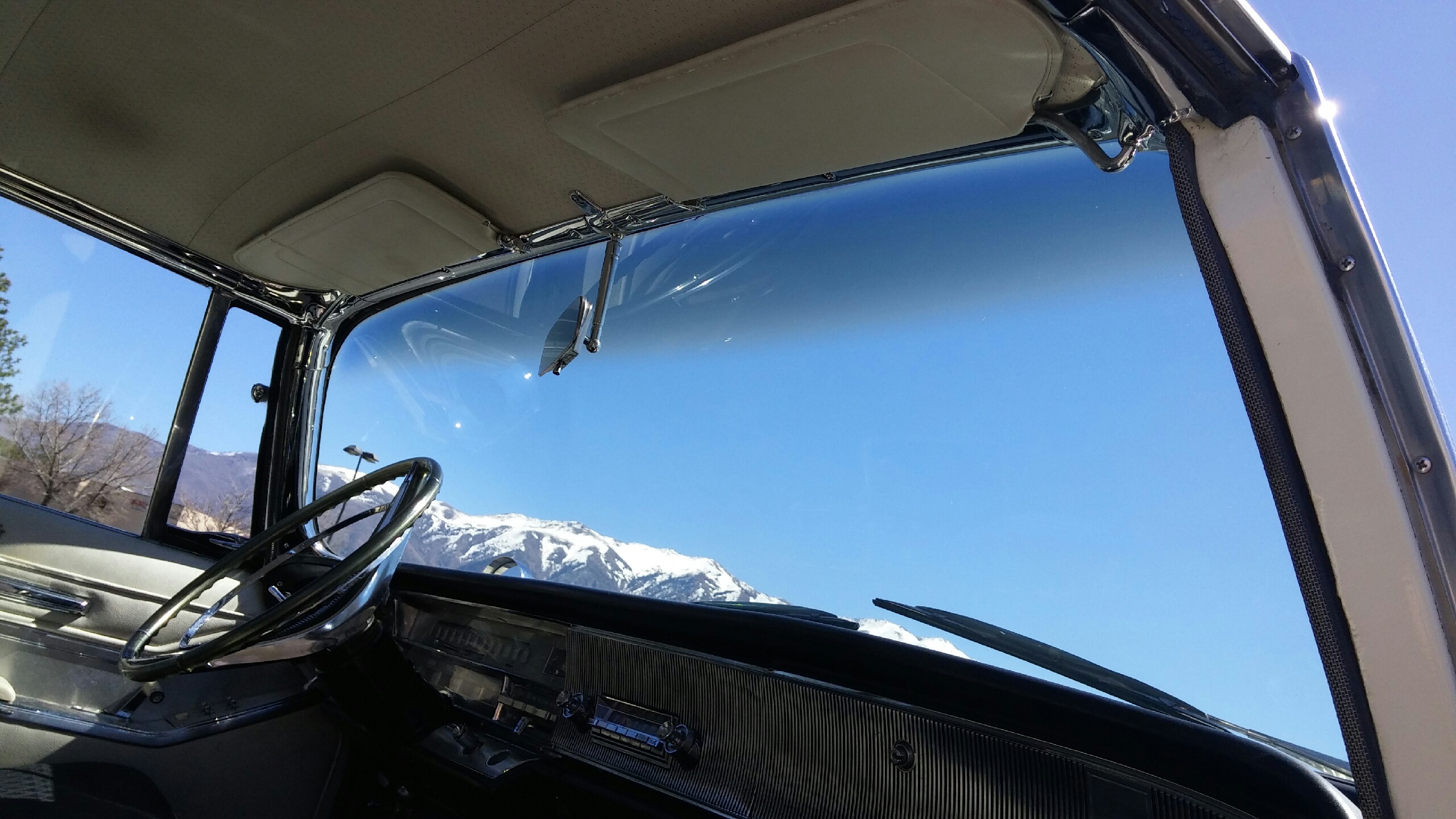

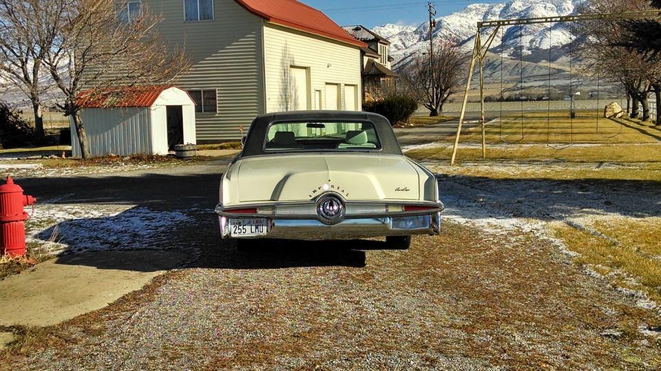

the interior is black and white. adding some pics of my car like i said its all original. why you ask about the interior? this is the interior of how i bought it, ive never even cleaned it yet the previous owner only put 5,000 miles on it in 15 years and its been garaged. the pics by the barn and stuff is the place i bought it and towed it out that day. rebuilt the carb and new battery and it came alive. ive had it a little more than a year i was working out of state so ive not had the time, ive still not even cleaned the interior or even washed the car yet its how i found it in the barn from the person i bought it from as is all ive done is spray it off with water. I am planning on painting it a Glossy Black. the interior will have to come at a later date will cost probably like $3,500 to be completely redone good, as is now the interior is fine though so ill worry about that later. has 64,000 original miles on it. been garaged the last 15 years that i know of and was put in a local car show the biggest in the state and placed 3rd in its class how it sits.
Attached Thumbnails ( First Engine Build ) 440 , Pistons / Heads / Compression Ratio Help-0329151236a.jpg   ( First Engine Build ) 440 , Pistons / Heads / Compression Ratio Help-0329151237.jpg   ( First Engine Build ) 440 , Pistons / Heads / Compression Ratio Help-0329151238.jpg   ( First Engine Build ) 440 , Pistons / Heads / Compression Ratio Help-0329151238a.jpg   ( First Engine Build ) 440 , Pistons / Heads / Compression Ratio Help-0329151238b.jpg
( First Engine Build ) 440 , Pistons / Heads / Compression Ratio Help-0329151239.jpg   ( First Engine Build ) 440 , Pistons / Heads / Compression Ratio Help-0329151239a.jpg   ( First Engine Build ) 440 , Pistons / Heads / Compression Ratio Help-0329151239b.jpg   ( First Engine Build ) 440 , Pistons / Heads / Compression Ratio Help-10858590_1391671391128169_9189093686392502812_n.jpg   ( First Engine Build ) 440 , Pistons / Heads / Compression Ratio Help-1610843_1391672187794756_2544790066092995431_n.jpg
( First Engine Build ) 440 , Pistons / Heads / Compression Ratio Help-67383_1391671354461506_6925453432781591542_n.jpg   ( First Engine Build ) 440 , Pistons / Heads / Compression Ratio Help-10408033_1391671431128165_1241139278409228766_n.jpg
