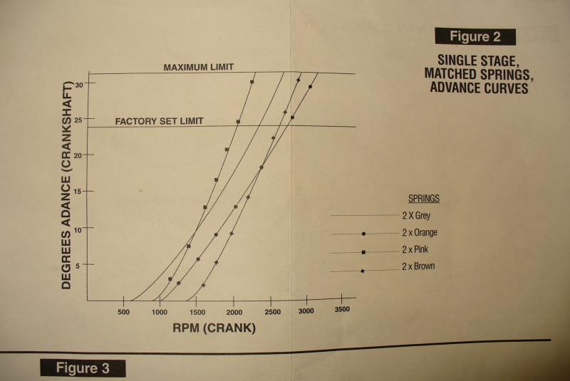

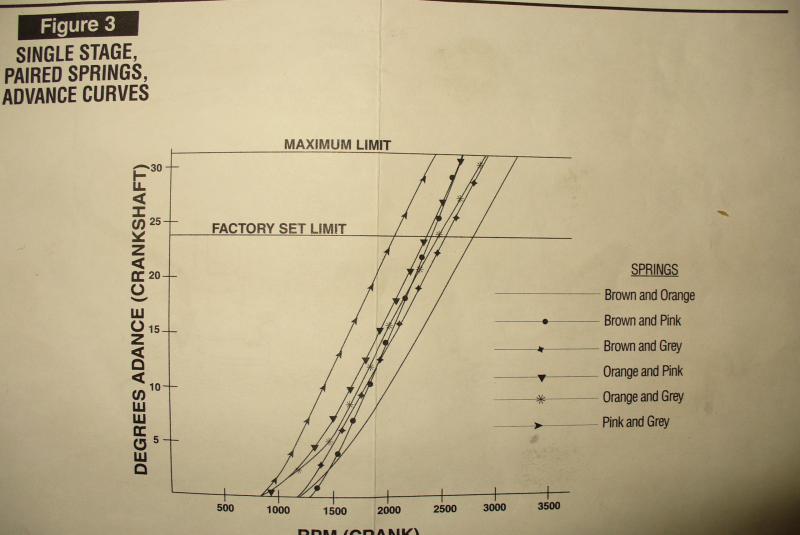

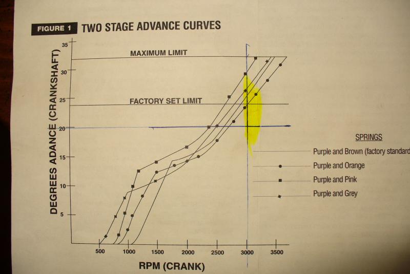

Or you switch to a Mallory dizzy and coil kit, do you really need the box?
Mallory has a nice tuning charts, and several springs, and you can limit total advance.. it's a nice system

Attached Thumbnails fuel ????-p1020280.jpg   fuel ????-p1020281.jpg   fuel ????-p1020282.jpg

Everything is MSD Distributor, Box, and coil but I dont see a way to change just total advance ther ar no wieghts or springs in the dist. just a pickup coil. I think more than likely my problem is the carb 600CFM s is just not enough for this set up. Correct me if Im wrong but here is what I got now that I sat back and got my head clear. 1) The engine surges on light throttle. 2) The car doesnt respond to the 4 barrel just kind of lays there. It picks up speed but not as quickly as it should. 3) Its running hot even with a new thermal clutch fan steel fan and a electric pusher fan, new hd radiator ect. I think it needs a 750CFM carb. So if you know where the best place to get a new one for reasonable money please speak up. THANKS to all of you for your help

Wow do I feel stupid!!!!!!!!! I just went on line to find out about these MSD pro billit Dist. and come to find out the curve can be adjusted and its easy to boot. So now I will change things over to what Bremereric was saying and try it. And for the lean condition I'll do a blast and pull a plug and see what I've got for a burn, and if there white than I'm off to get a carb. Anybody know a good place that sell carbs? I know jegs summit and all them but theres got to be a discount place out there I dont know about.
