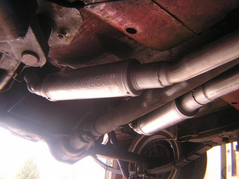

Sounds great! What mufflers is it wearing?

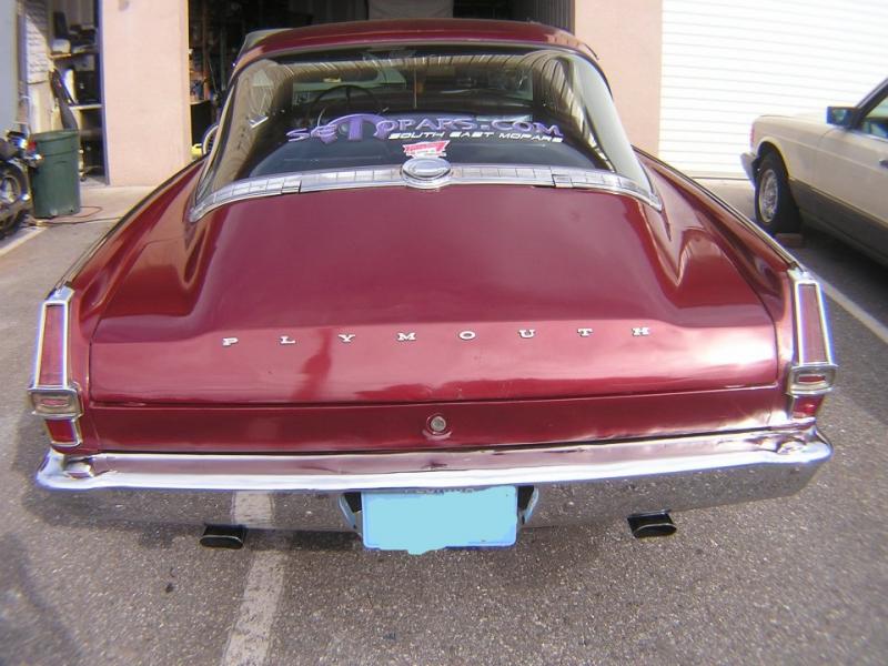

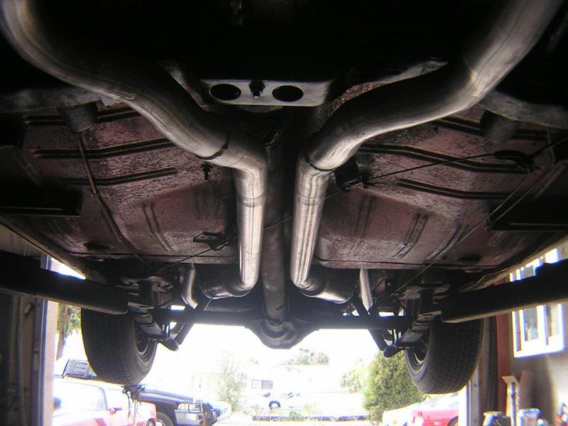

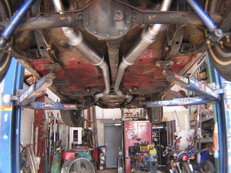

Thank you,My setup is as follows 1 7/8 or 2 inch head pipe to the bottom of the firewall [to clear everything] bumped up to 2 1/4 inch mid pipe stepped up to 2 1/2 for the Stainless Magna Flow Magna pack mufflers then back down to 2 1/4 over the axle to the rear bumper then stepped up to 2 1/2 for the oval stainless tips. I wanted to use Flow Master Series 10 race mufflers but my exhaust guy talked me into these.
