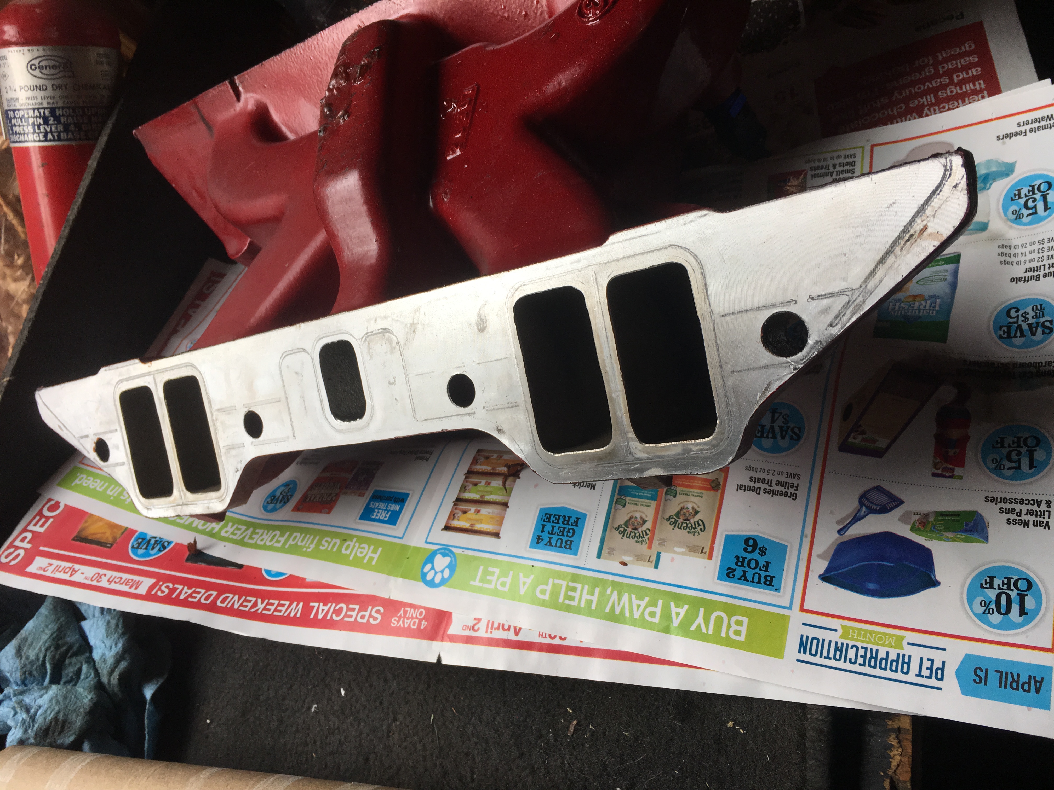

go intake and belly pan off today there was no gaskets
so I will post some pictures here I took the edelbrock performer intake off with a little difficulty trying to get the 2 8mm allen bolts out with an extension and socket. It will be impossible on the two as the manifold sits high around the two bolts. I wonder if I can use an allen key 8mm if I can find one or is there another tool you suggest? There was no gaskets under the belly pan or the manifold, just some orange silicon like stuff in the bolt holes and the front and rear plates that hold the belly pan. Went to the auto parts store, I am getting the kit with 4 gaskets, new belly pan by fel-pro.
I was told the "right-stuff" gasket sealer was like glue, and in the future be hard to remove if I need to take the intake off again. I want to use it, because I don't want to do this job again. It sounds like a great sealant but maybe the aviation gasket brush on sealant would work similar they say to the edelbrock gaska-stuff.
Also, how long should the bolts stick out of the manifold into the head. I have about 1/2 inch and I bought some antiseize for the bolts to put on.

Pictures
Old Apr 24, 2017 | 07:10 PM
Those photos told me it was sealed??????? But will just go with it was not...
As for the allen wrench, You can cut one short if you need too...
Dont go nuts with the sealer. A light coat is all you need. Use what ever you feel easy for you to use, if my suggestion dont fit. Trust me, I'm not going to get mad...lol I use stuff most folks wont even buy. Its way to expensive for there budget. I'm a pretty passive guy...lol
As for the bolts. It will depend if the bolt holes are Blunt or go all the way threw the other side. If there blunt holes, dont use bolts too long. If they go all the way threw. Dont use use bolts too long, A couple can interfere with push rods. You just need them to be long enough to just go out the other end, and those you will want to add a little sealant to so oil wont push out the threads and make a mess. The others for the blunts, I like to see a little Anti-Seize on.
Just my 2 cents...
Good luck with the install..
Looks like you did a good job on the last install, Maybe the bolts just worked loose?
