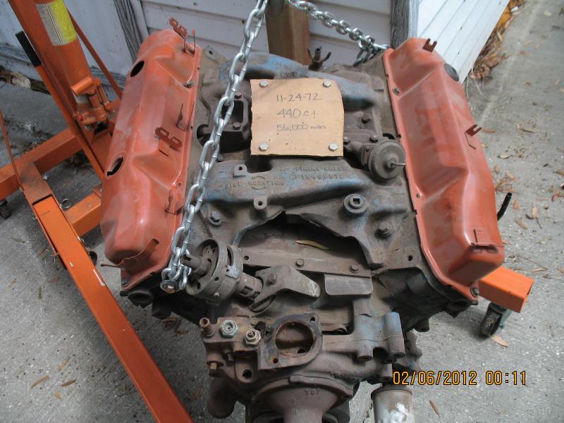

pics of the starting point, big help with the big block
Attached Thumbnails starting points-440-new-002.jpg   starting points-440-new-001.jpg

I agree with the parts recommendations also with holding off as they can be added with the engine in the car. There is always the unexpected and too many guys run out of money before they get rolling.
The one thing I would do with it out is remove the oil pan and weld in acceleration, deceleration baffles and possibly deepen. This is a wise purchase at this time if you can't fabricate yourself as changing this later with engine in the car will be much more difficult. Nice pose, like you bagged the prized deer or fish.
