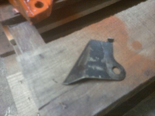

It came with my motor i just bought and was zip tied to the camshaft locking plate but i have no clue what it is..Thanks

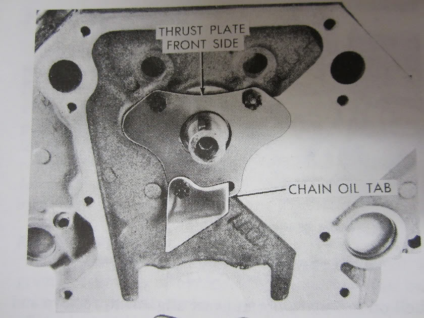

That is for a small block. It bolts to the cam thrust plate and drips oil on the timing chain.
Old Mar 22, 2012 | 09:11 PM
Here's a pic out of my service manual.
