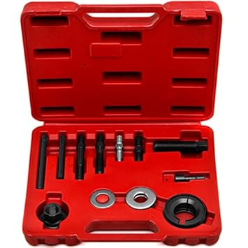

You may also need a "PS pulley removal tool" if the pulley is stuck on the shaft. You may be able to borrow one through the tool loan program of your local auto part store. Access to an impact wrench to get the pulley nut off wouldn't hurt either.
