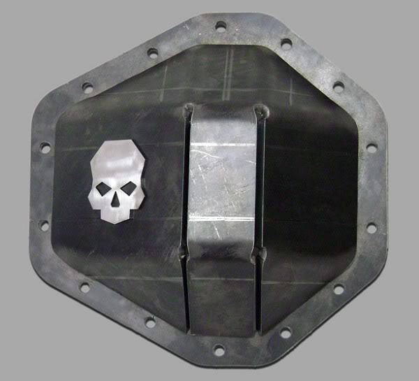

The rear axle of that 84 Chevy will probably be a 14B though, not a D60 (see pic of diff covers below to tell the difference). Chevy stopped using the D60 as a rear axle in their trucks in the 70s (maybe earlier). The spring perch widths and shock mount locations are going to be different either way though between the axles and makes.
14B rear axle diff cover shape:
D60 diff cover shape:
