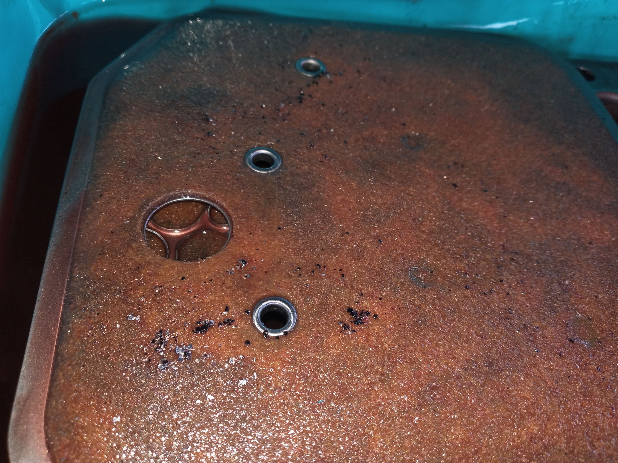

I pulled the tranny yesterday and dropped the pan and found little bits of metal and a bunch of greyish, metallic looking paste/sludge on the magnet and also some little black bits on the filter and valve body...

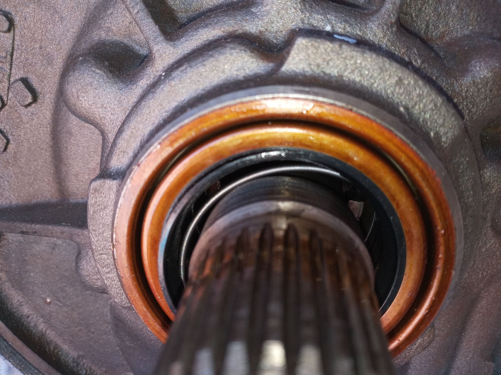

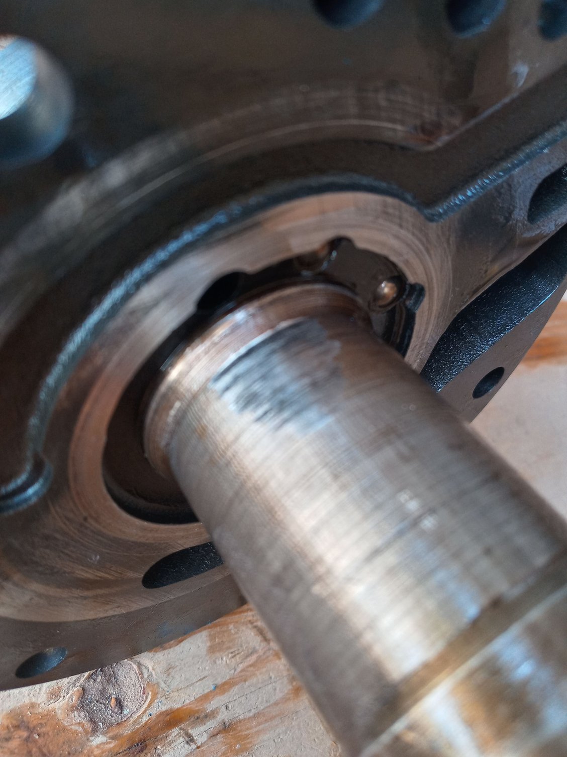

Update with some pictures...

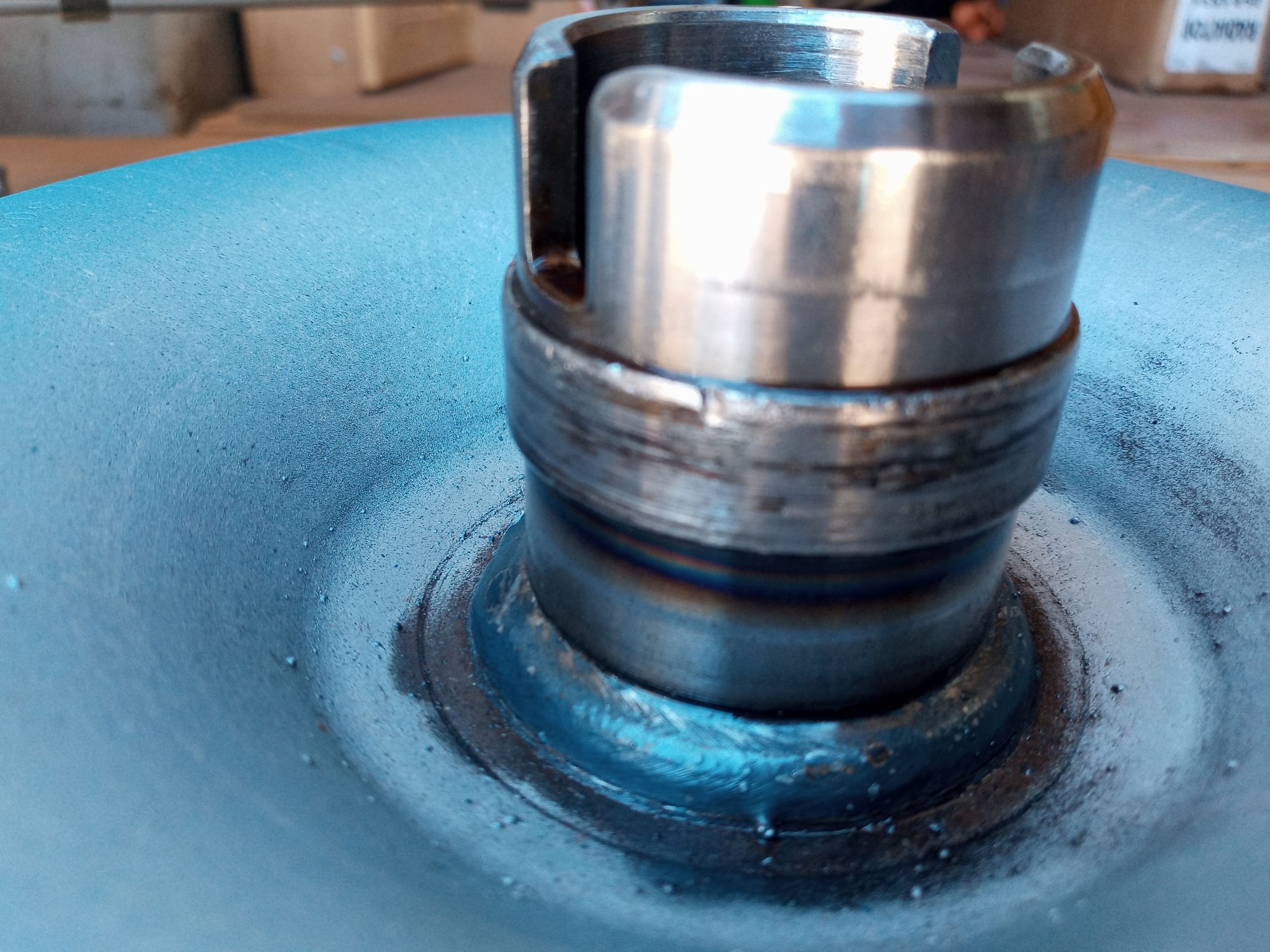

I was finally able to yank the converter out ...
The pictures speak for themselves...
I see a damaged race seized onto the converter shaft and the seal is completely broken and detached.
The race I assume went to the pump bearing?
How could that damage have happened???
I'm going to pull the pump and see what the damage is, I'll return with an update and pics...

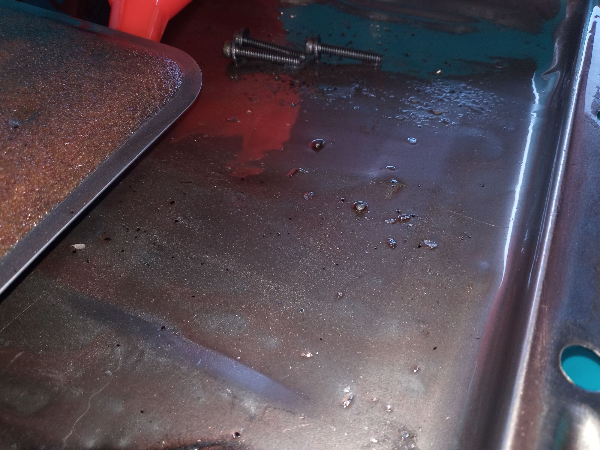

Took the pump and pan off...
lots of metal flakes and bits but not sure from where...

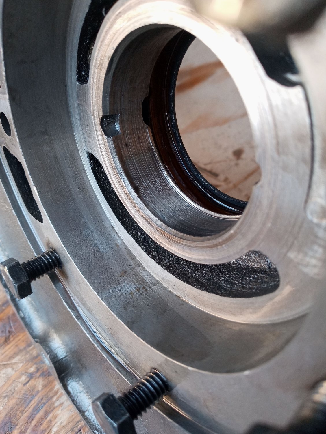

That thing I called a race earlier that's seized onto the converter shaft ground into one side of the pump...
Here's what I've found so far...
Is the band suppose to have that much of a gap??
Looks ground into by the ring on the tc shaft...
The ring that's seized on the converter shaft ground into the pump orifice... This would explain the fine metallic sludge but not the bits and pieces of metal...
Looks like a little contact wear... Is this normal?

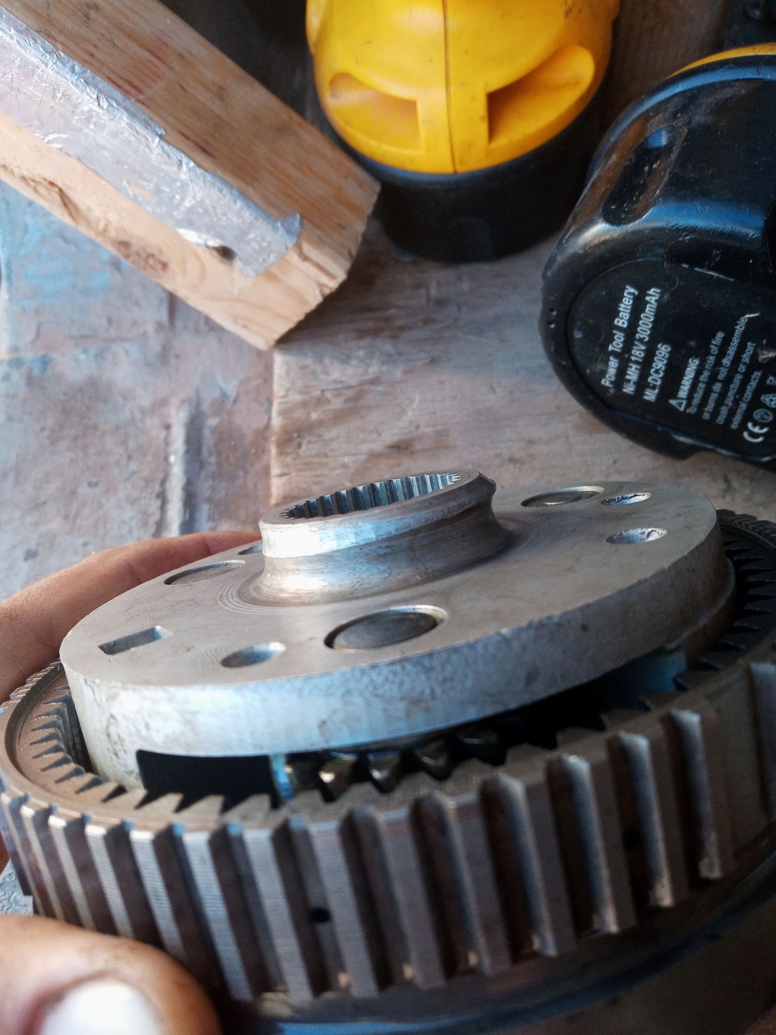

Now that I know what it's called it's the 'oil pump bushing' that seized onto the converter shaft and ground away at the inside surface of the pump...
This is where the metallic sludge came from, also some of the smaller metal flakes but I still found some larger bits of metal that kinda look like weld splatter...

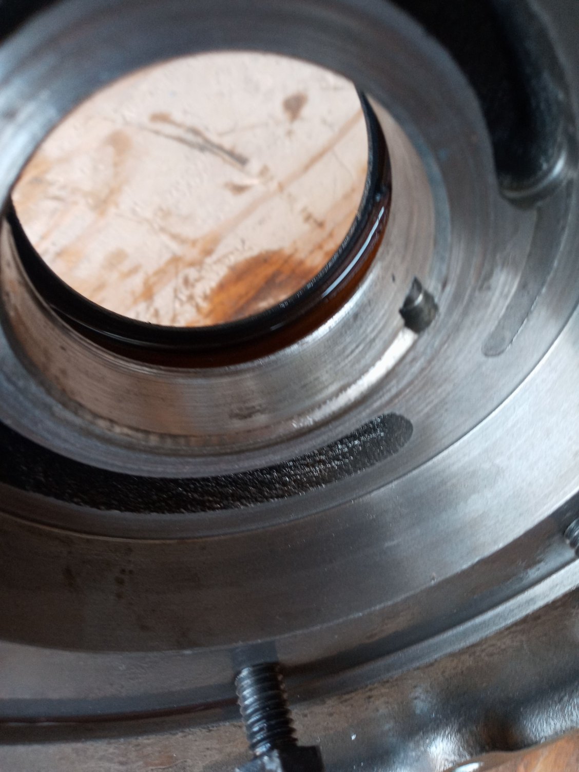

I believe the seal is where all those little black bits came from...
Old May 26, 2021 | 08:04 AM
DanZan's Avatar
Joined: Feb 2021
Posts: 18
Likes: 3
From: Arizona
The question is...
Why is it so off center???
I think I may have bent the flex plate during initial removal(before the rebuild).
If the flex plate is bent I can see how it could wobble and damage the seal and stick into the oil pump bushing but could that be the reason there's no reverse??
Maybe it's the converter shaft that's off a bit???
Could the stator and body(pump housing) be misaligned?

It looks like the transmission center line is off from the crank center line.
Was it a new torque converter or your old one? A converter hub not centered would raze hell also.

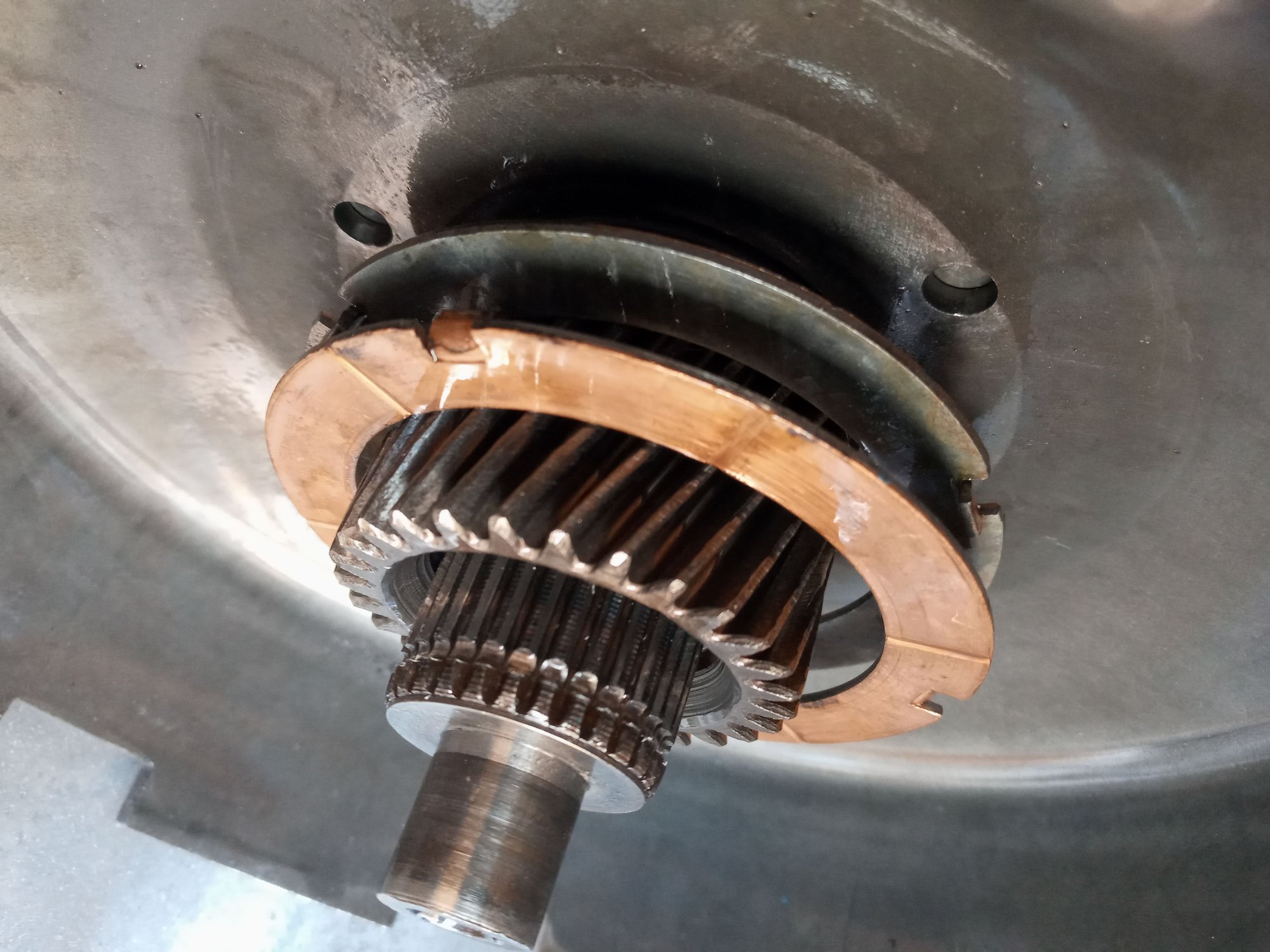

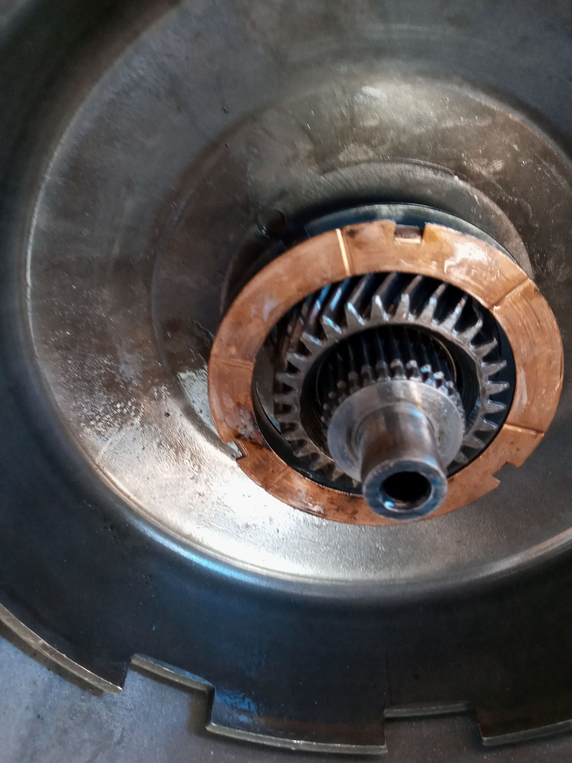

Can someone tell me if there's something wrong with this picture???
If I'm not mistaken there should only be one of those spacers and the three tabs should be in the three holes towards the drum correct???
This is exactly how I found these spacers...

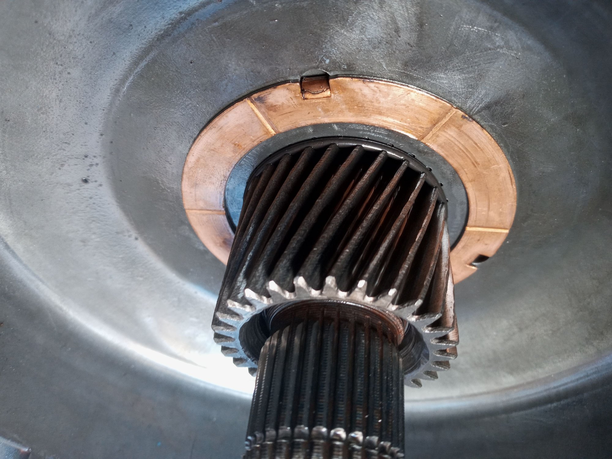

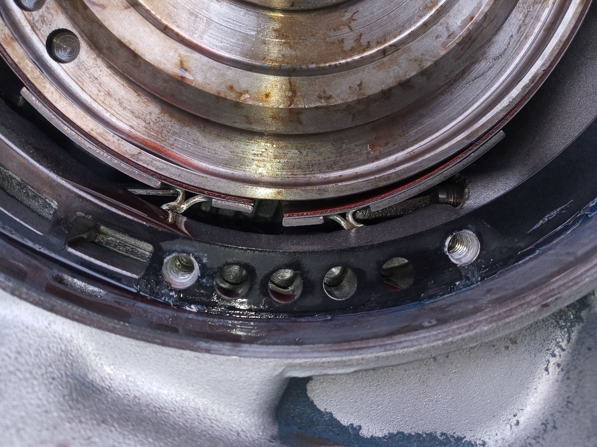

I'm pretty sure I figured it out!!!
Take a look at the pics, I'll comment under each one...
Take a look at the diagram because behind the 'front annulus gear assembly' goes ONE 'thrust washer'!
This is where the ONE 'thrust washer' in the diagram is suppose to go... See the holes where the tabs on the washers go into??? This is how it was assembled by the shop I paid to rebuild it twice!!! What?! There's even a stain from where it use to sit! This is what threw everything off balance!
This is what its' suppose to look like according to common sense and the Technical Guides diagram... Wow just wow...

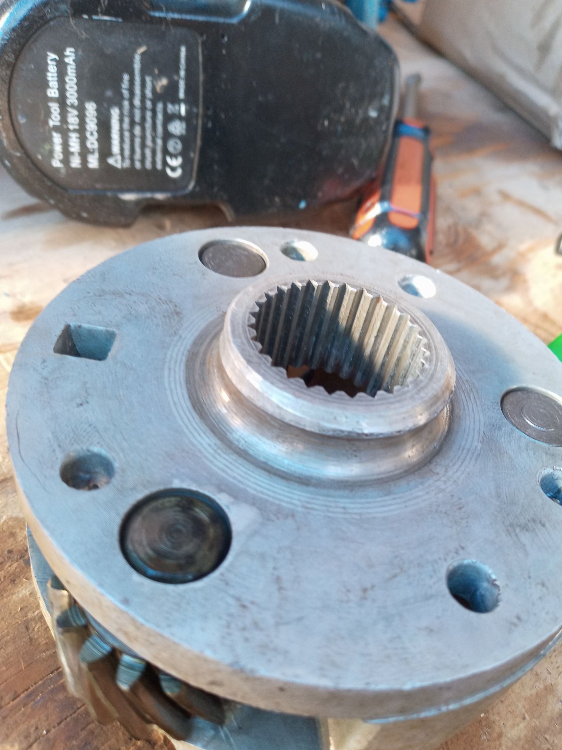

This is part of the damage cause by the gap created by the two washers incorrectly installed behind the 'front annulus gear assembly'.
Ill' probably have to replace this... Right??
I'll provably have to replace the converter also? It's a cheap one but if it works it works... I can heat or cut the bushing off...
What about the oil pump body/housing?? Too damaged?? Probably a bad idea to reuse it...
I'm going to keep taking it down and see what else I find...

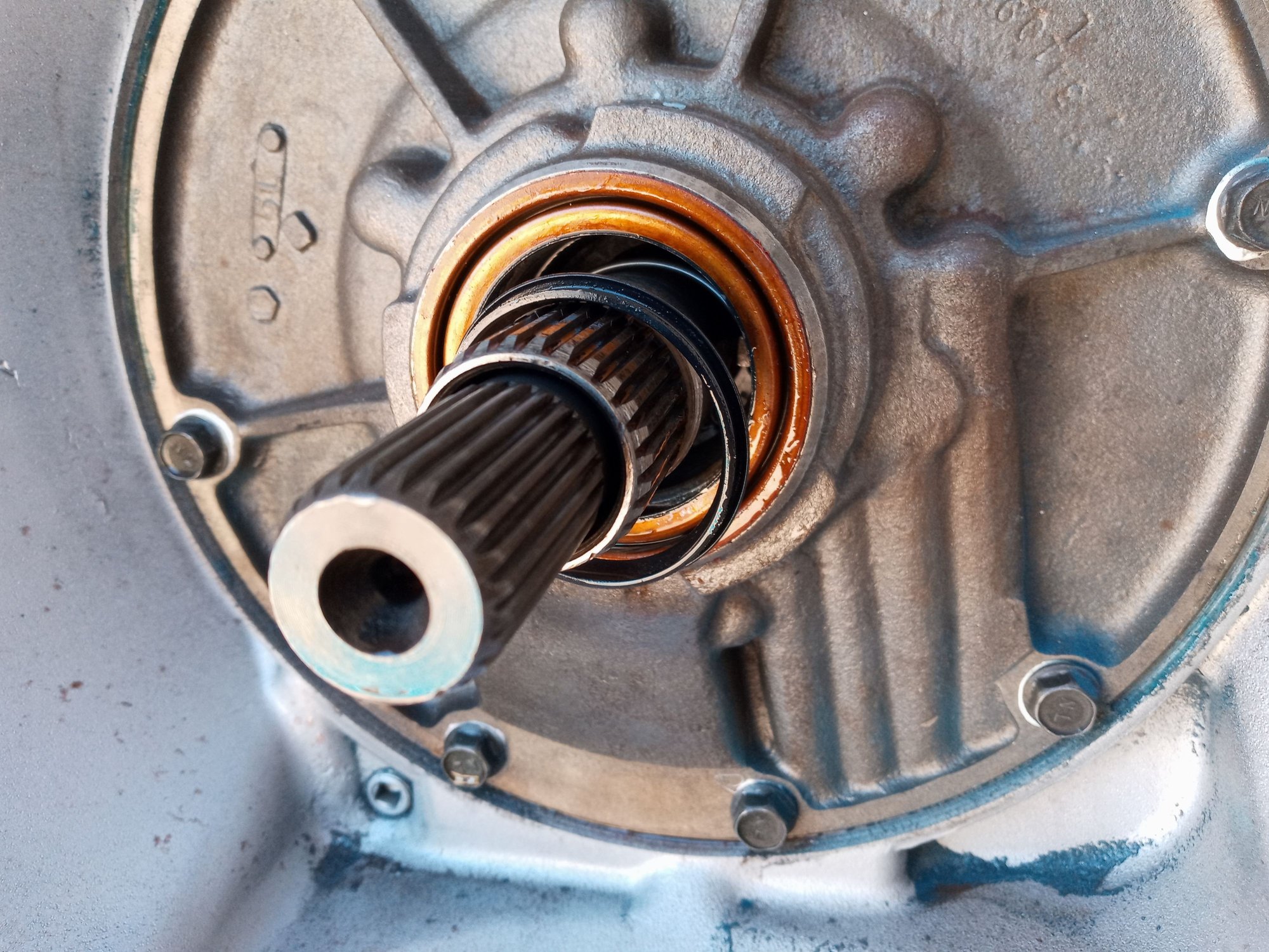

So as I research this further I've noticed that in the manual (ATSG Tech Guide) it shows that the bushing that sits in the pump body(the one that's seized onto the converter) is suppose to be 'punched' in place with a blunt punch into the pump body and the shop didn't do that!
I can't believe I'm finding so many mistakes!
I really don't want to believe it but I feel like I was sabotaged... or maybe the shop owner had a rookie employee rebuild it for him...
I'm definitely going to have a talk with the guy I gave money to rebuild this thing!
The picture shows the bushing needs to be punched into the pump body.
Those two little 'notches' on opposite sides of the 'bushing bore' hold the bushing in place when punched...
It doesn't look like they "staked" the bushing to the pump body...
Between not staking the bushing to the pump body and creating a gap by installing two thrust washers where only one was needed it threw everything off balance and caused damage.
