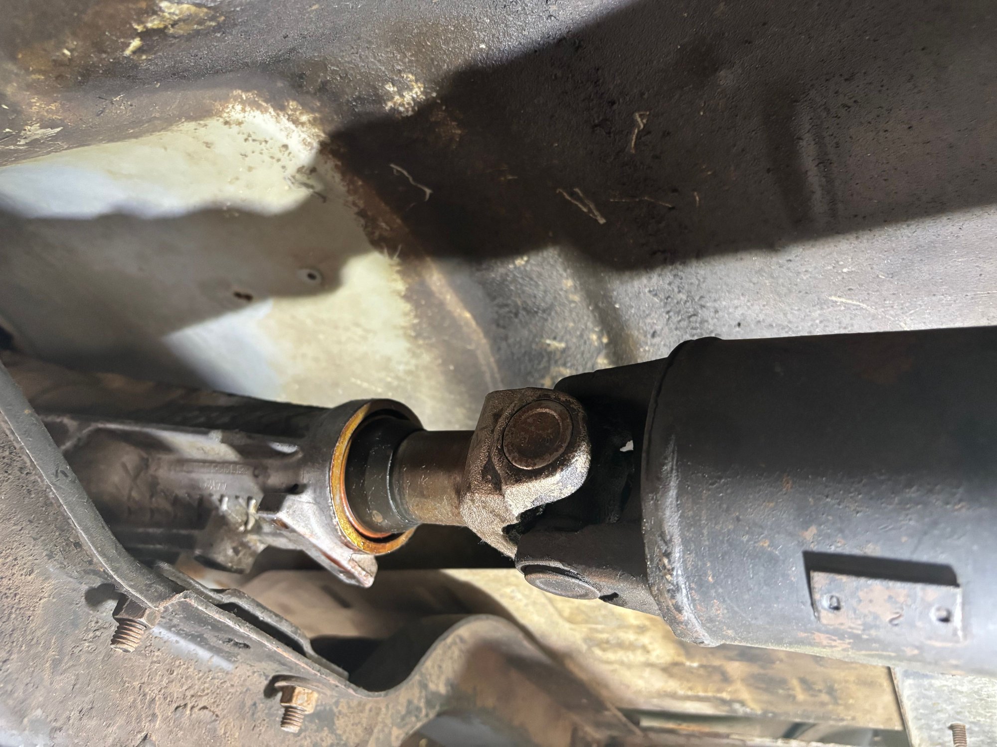

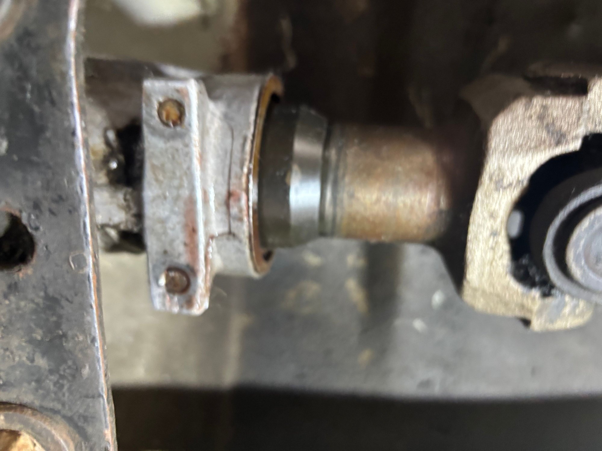

On my 1990 Dodge D150 with the 318 5.2 engine with a transmission that says 90 on it and a code of 4412465 at the rear of the transmission, on the bottom side of the casing there are two broken bolts in the casing what would’ve went here. On the crossmember there’s some kind of a bracket bolted on.
Is this some kind of transmission mount? I can’t seem to find any pictures of what I’m missing.

I can’t remember what goes there if not the transmission mount it’s possible that a vibration dampener would bolt on there.

This is what a google search turned up. Although I found these images on a forums for diesel trucks I think it still gives a pretty good idea of what your truck may of had.
It looks like the mount is made of four parts. The cross-member side bracket (which you seem to still have), the rubber (which can be bought at your local auto part store), the transmission side bracket (which you will have to find or fabricate) and the bolts that hold it all together (which substitutes can probably be found at the your local hardware store.).
Picture of new rubber part:

Here is a parts break down... everything is discontinued of course. Look at item number 25 and 32.
https://www.moparpartsgiant.com/part...agram=000006CC

Thank you for the pictures and knowledge I can quit pounding my head against the wall and get back to work!!!
