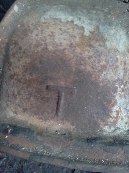

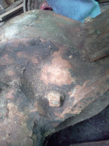

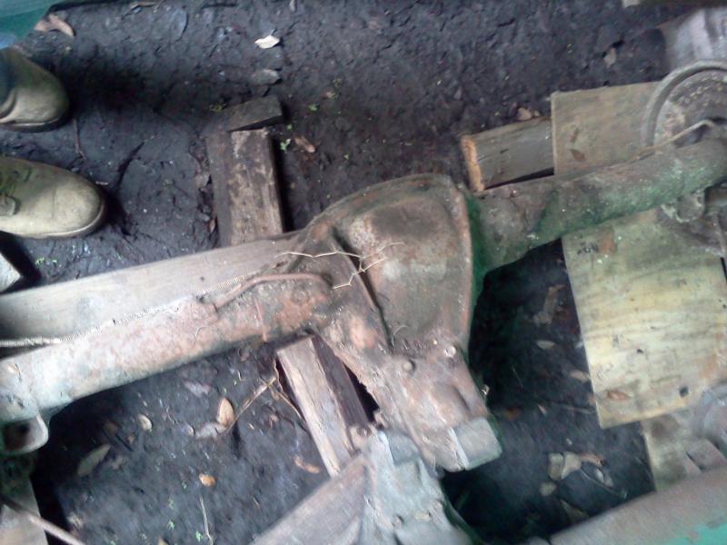

Smile What's this rear end?
what mopar was this rear end out of?

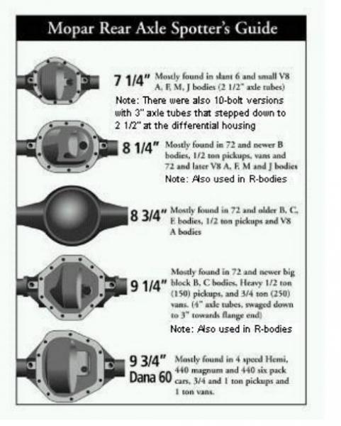

Just tried uploading a jpg, got the same results as Gorts
Archer

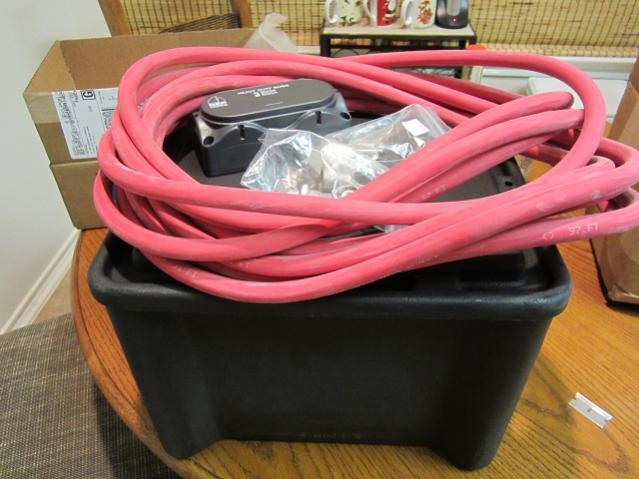

Same with me.

early 9.25?

yes it's a early 9.25
wondering if the "T" on the top might identify the type of application... it's one tough reinforced looking rear end

Been using a 9 1/4 for about 30 years. Generally not a popular rear, but I've had good luck with mine.

What's the lug pattern on it and WMS to WMS measurement?
