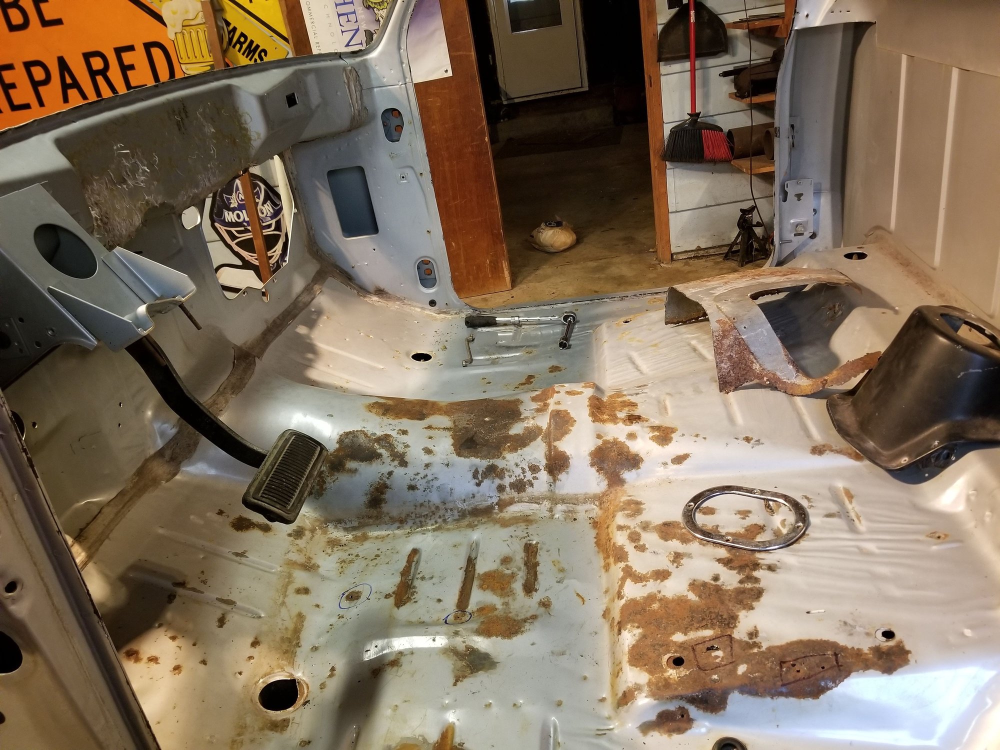

Heres a picture of the old and new. The old cab floor was to far gone in my opinion. Didnt really want to go in with new floor pieces because the rust had progressed to much and honestly didnt want the headache. Considering i got the new cab as a throw in for buying the truck i think it was the right move lol. I think i could cut out a floor section and modify it to fit the shifter boot, although i dont have the linkage attached, but it looks as if i have just enough room for everything to work properly and still have room to do any repairs if needed. Just want to know if anyone else has ran into this and the route they took. This is my first remodel so learning as i go

Yeah.. that old cab looks pretty bad.
Other than the humps, the floor stamps look the same in both cabs. I wonder if you could obtain a replacement hump that wasn't all rusted out if it would fit right?
The hump would have to be from another truck. I tried looking on Goodmark and LMC Truck. You can get the floor pans where your feet go, but not the hump.

Oh yea everything lines up perfectly. Yea iv looked all over and havnt had any luck finding a replacement hump. Tried calling LMC to see if they had or knew of any company making/selling any. No luck there. I think im going to just cut a hole big enough to run the shifter thru to see if the linkage has enough room to do its job...then try and fab something to go around it...
