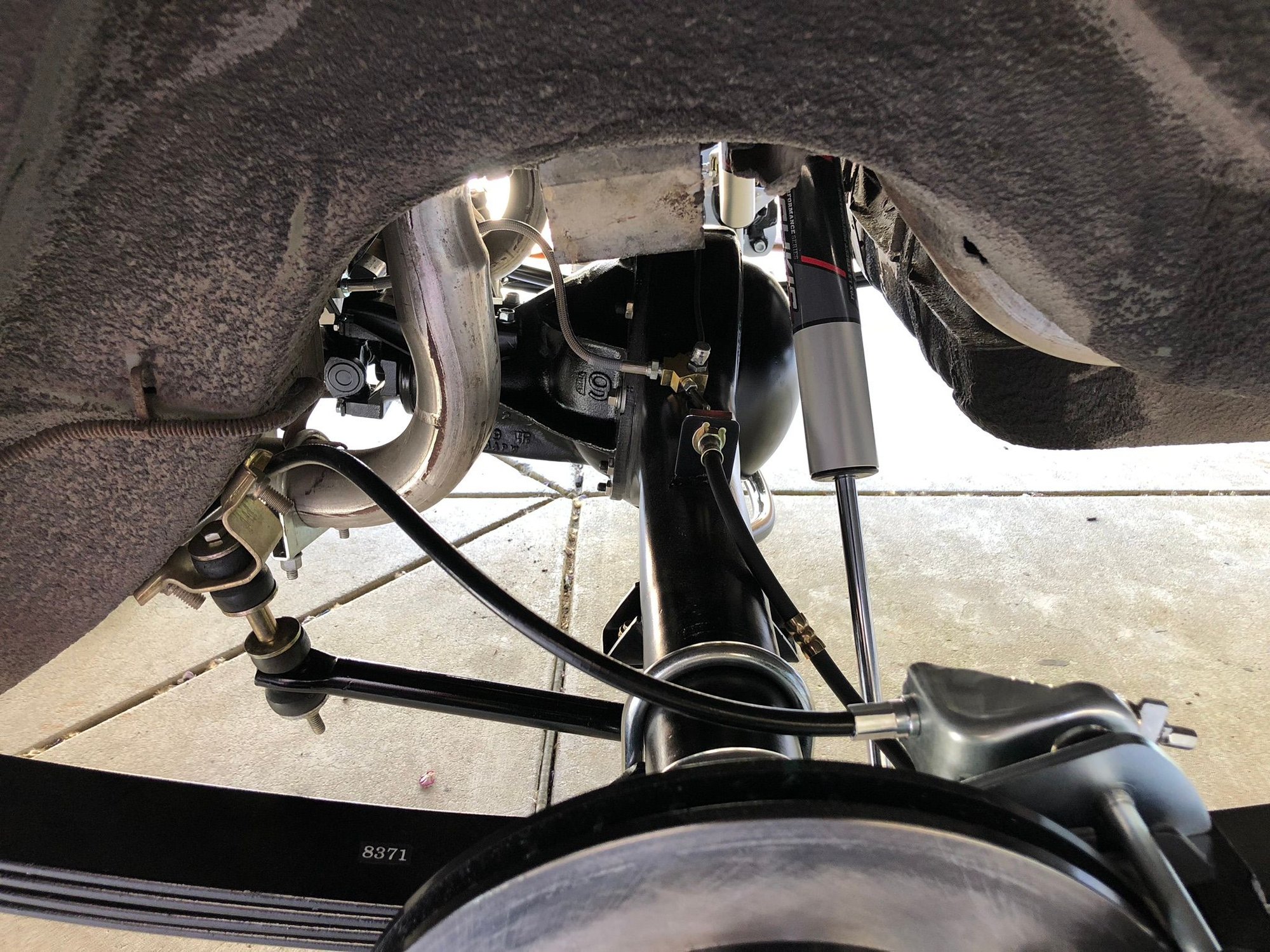

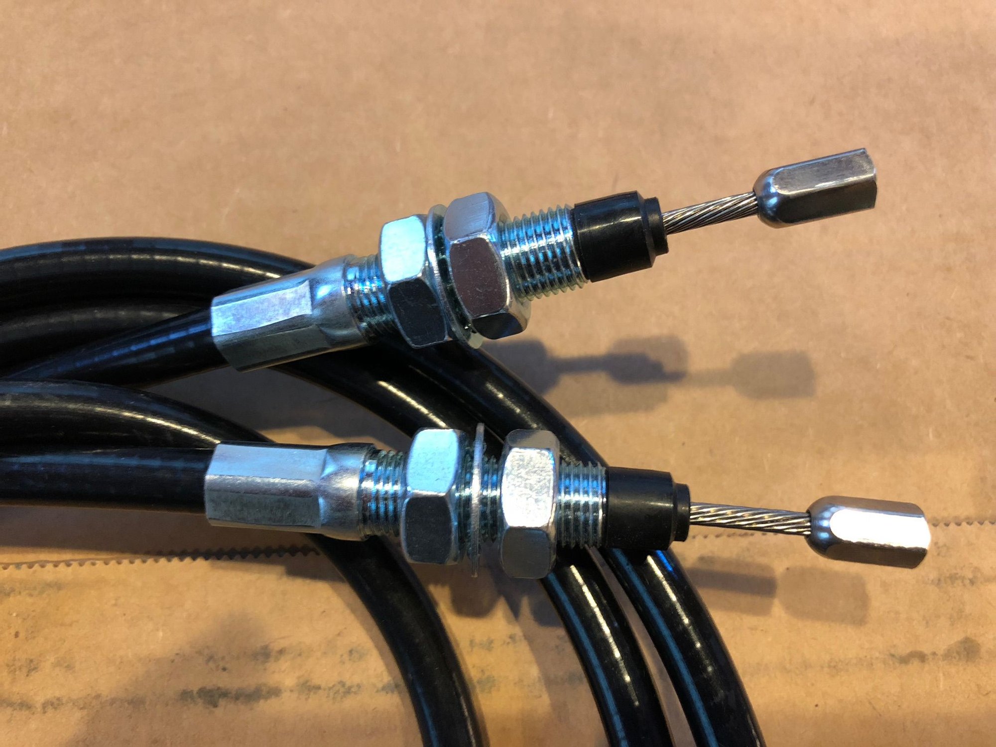

I used Control Cables and I am glad I found these guys. I will use them for all my cable needs from now on.
The pictures may be a little big
Hope this helps!

Good information and detailed photos. Well done!

Thanks for the information and pictures. It was a great help. After confirming my lengths I ordered my cables.
