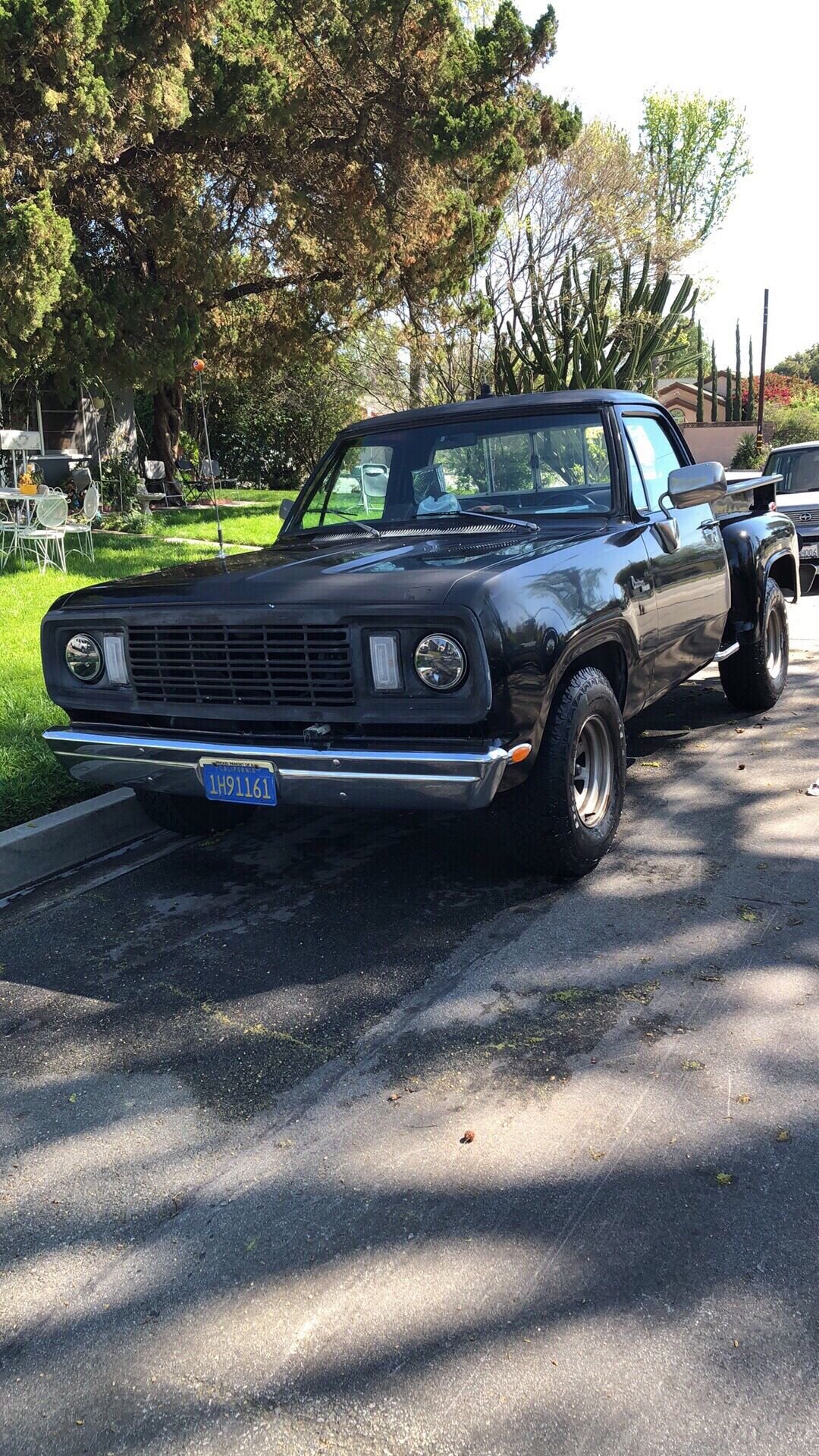

Your telling me... My Daily Driver is a 1977 Dodge D150 "Warlock" Pick up with a 360 V-8 and a 727 Auto Trans.... It has clocked over 500,000 + miles. (Not all Original installed parts) but never the less) Still my daily driver. And the truck has only been towed home 3 times in its lifetime.
