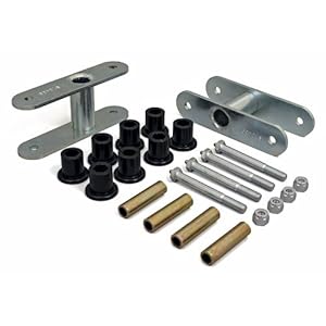

Those AFTERMARKET so called "extended shackles" are JUNK Get rid of 'em. One thing you must understand is that the seemingly simple leaf spring rear suspension MUST not be taken lightly. When you "jack up" the rear of the car with those extended shackles, several things can happen, not the least of which is VERY POOR CORNERING. This is because the now "too long" and "too sloppy" shackles, "lean" with the force of a turn, allowing the leaf springs to twist and move to one side.
Most of the time, they don't do 1/8 or 1/4 track times any good, either. They ruin weight transfer, at the very least
The BEST (non factory) shackles are "boxed" that is, the two sides of each shackle are tied together to stiffen them from moving
Here's one example, just a generic photo I stole from Al Gore

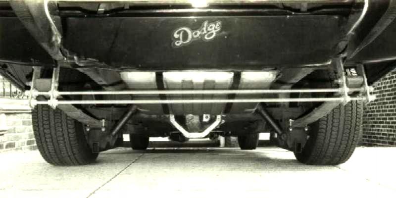

We had another way of doing it back in the day ...
Archer

Archer, that's the basis of the "IHC SCOUT" style shackles. On my LC, I just installed the "bolt" end facing in, and replaced the "strap" with a piece of angle. Drilled the outer face, and took an old piece of spring leaf and bolted it across.

So in your opinion, would that kind of set up be a plus or minus on a B-Body?

Arch, is that a kit or did you fab it up yourself? I like the way it looks and doesn't seem like it should be too expensive compared to replacing a whole bunch of suspension parts. Plus I LIKE old school.

Home made. 1/2" x 6' threaded rod, cut to length and with the appropriate washers and nuts. The trick was to lock up each side of the shackle.
Combined with the traction bars, the rear was pretty solid.
Back then, I also used independent air shocks, as a cheap way of dialing in height and L/R balance
