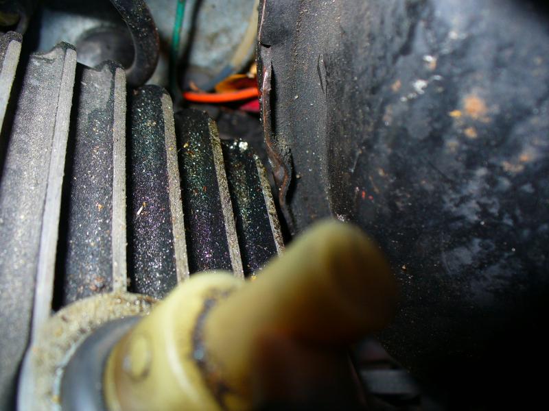

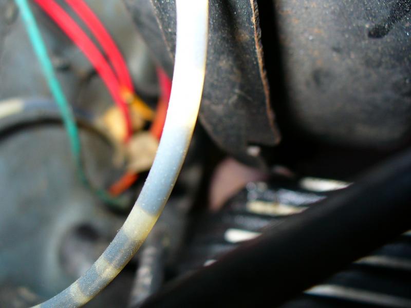

Ok gent's i am looking to repalce the power booster in my 86 5th ave.
I have clearence issues with the Valve covers touching the edge of the booster.
Not a continual rub but its making contact when the engine is torquing over to it's right.
I have a turn buckle too hold her down but i would like to put a little slack in her.
So What Would you guys suggest for a POS booster to replace the installed POS.
I was told that a booster from a k-car would work. any suggestions?
Attached Thumbnails What Brake Booster?-p1020412.jpg   What Brake Booster?-p1020411.jpg   What Brake Booster?-p1020410.jpg

Nope it's easier to find some of the mid 70's darts with the smaller boosters. 7 in to 8 in boosters have more clearance the the stock 10 in boosters in 5th aves.
