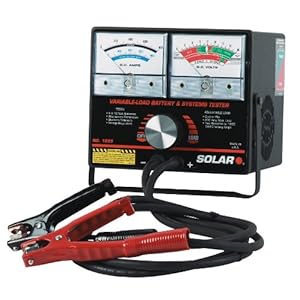

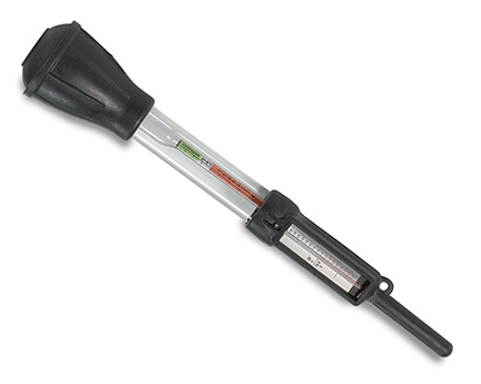

1. Find someone with a REAL (carbon pile) battery load tester, charge the battery up, let it sit at least a couple of hours after charging and have it tested. If you can get the caps off, have it tested with a good hydrometer as well --one with a thermometer
carbon pile load tester:
hydrometer:
