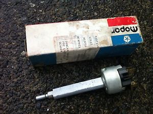

Well i have bought a "new" switch on the internet. The seller told me this new switch came out of a charger from 1973. I have noticed a difference between the switch i have and the one i bought; they basically look the same, but the one from the charger has one more stage in the rotary movement. Also there is a little iron box on the side of it, with three leads going to pins on the connector.
The motor i have is listed in the internet as a 3 speed wiper motor, is this possible? I have added a picture to this post to show you what it looks like. Also pictures of the switches, i couldnt find a better example though (sorry).
Also, i have bypassed the wiring of the motor to the switch (i used the wiring diagram for that). Result is still unchanged: only one speed with my old switch, zero movement with the new one.
regards. Willem

Should only have a 2 speed motor.....
http://www.mymopar.com/index.php?pid=28
See if this will help you trace the issue.
Might have one of the speeds burnt out of the motor.
