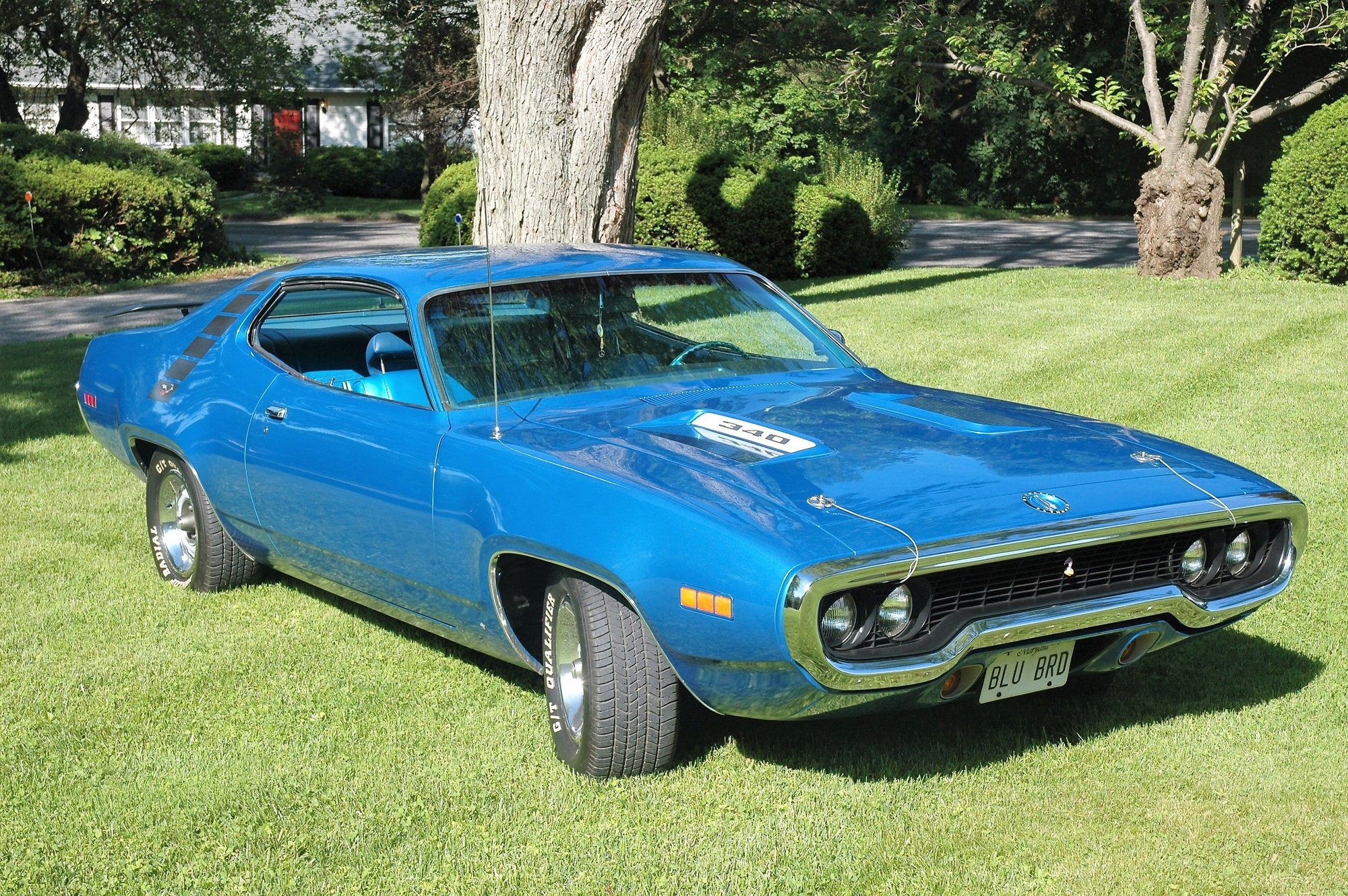

Hi Folks:
Inside door handles open door easily but outer door handles seem to "stick". You can open the door using outer handles but difficult.
Car is low miles and very good condition. Grease does not seem to help.
Seems like outer door handles mechanism not engaging correctly. Is there an adjustment?
Thanks folks!
