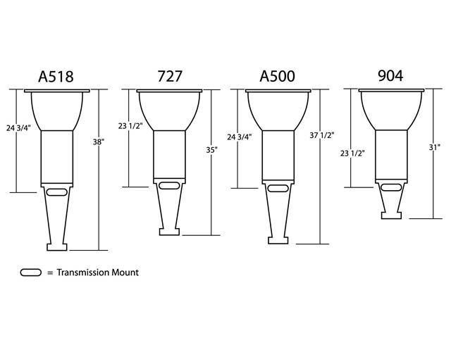

i have a transmission from my duster and i sold the duster and i dont know how to find out what type of tranmission it is, can anyone help thanks
Old May 25, 2010 | 06:27 PM
blue 68 gts's Avatar
Joined: Jan 2007
Posts: 1,117
Likes: 18
From: Lynnhood, Wa
For automatic transmissions:
https://moparforums.com/forums/f62/7...mparison-6092/
If its a manual, it should say it on the case IIRC

thank you that pisture helped i measured it and it was 31 and that is a 904 according to that diagram thanks again =)
