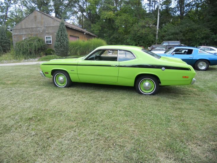

My brother and myself restored this old Duster a few years ago. We were going to sell it and try to make a little money. Now we are thinking about converting it to a V8 and making a fun car to keep out of it. The body is very solid and the interior is really clean, it just needs a little go power. The problem is that we are not very well versed in what combinations will work in this car. We are looking for some common sense suggestions.

It's well worth while but not cheap..Need to change the rear end, drive shaft, the trans, the radiator, the engine & related brackets. and shumaker motor mounts, and headers...
Or you can hop up the 6 Check Clifford Research for hop up parts, good valve job, .060 cut off the head, small 4bbl manifold and carb 450cfm ??

We will replace the fuel line. The Duster already has new black wall tires also. So hopping up the 225 slant six would be popular? The car does have a front brake upgrade and the fold down rear seat.
