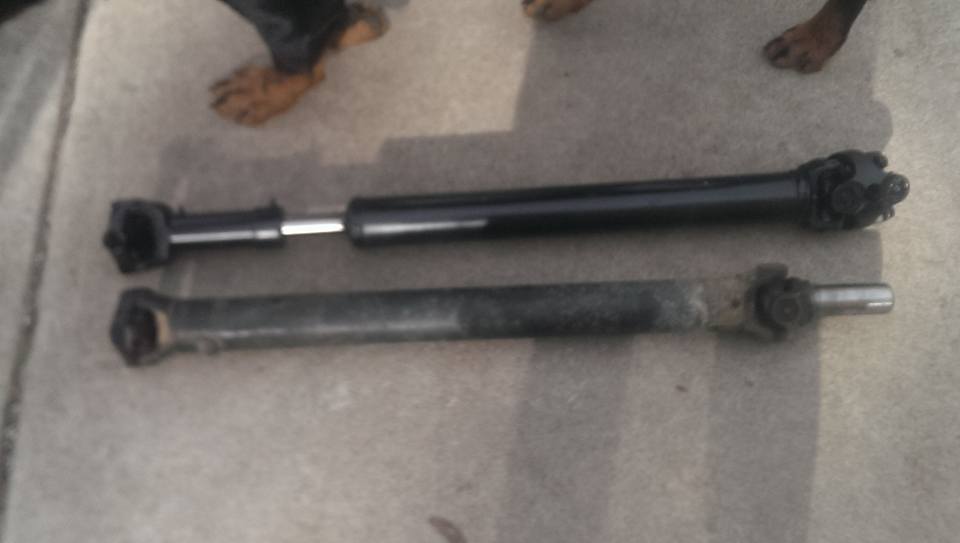

Decided to coat cage and fender armor in bed liner. It added texture and tied into the bumpers very nicely. Truck bed liner went on smooth. Scuffed, prepped and laid down. First time using so it isn't show quality perfect but we mixed with mixer regularly and kept texture fairly even. Had way too much bed liner mixed so did rear cargo hatch also.Will have to get some better pictures tomorrow.
Been busy getting truck ready to go. Got SYE installed with another drive shaft from Bill's Englewood Drive Shaft. Took truck to car wash and it drove good. Had some noise from rear brake but got it resolved.
While setting past several months truck had grown some surface rust. It wasn't washed after last trip out in February. Wire brushed it clean and touched up rubberized undercoating and paint. Truck looks much better now.
My list is getting shorter!

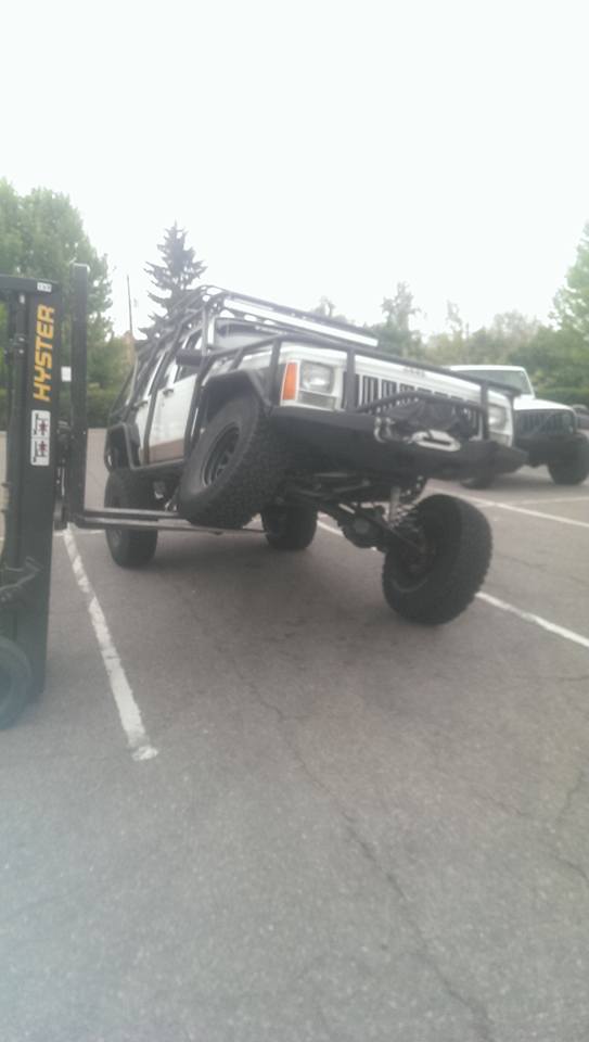

Got truck out yesterday for a quick run.Had a great trip out and truck did very well. As usual there is a new list now to take things to the next level. Primary issue needing resolved is a cracked exhaust manifold, will likely replace with a JY one until I can get a header. Radius arm still hitting factory lower control arm mount, will need to clean it up more. Coil springs are crushed at the top, will be looking to replace them with a more solid spring. Need to replace e brake cables and lower radiator hose. With steering working so much better since Currie upgrade, going to change pitman arm back and see how it drives with things properly aligned again. Still getting noises from y-link, going to pull apart all bushings clean/inspect/grease and replace as needed. Had a last minute oops on Saturday that almost prevented us making it out, had to grind off some bolts for the axle end bolts. New t-bolts should be here this week to get those right. Some movement in leaf spring mount, going to box it in and reinforce it. Thinking about using the Rusty's but welding in instead of bolting and completing it out to fully box it in.
http://www.rustysoffroad.com/rusty-s...-brackets.html
Rear doors do not open enough to access back seat anymore, working on something unique to resolve this issue. If we can pull it off it will be extremely sweet. This will take months and some JY doors to pull off so don't expect this to unveil soon.
Here is my favorite shot from yesterday, shows driver side bump stop not doing it's job. Wheel was all up in the wheel well, drive shaft hit radius arm and coil spring over compressed

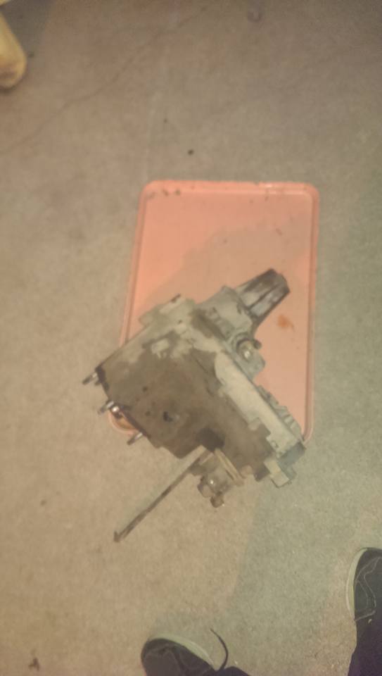

Old Sep 19, 2015 | 09:11 PM
  #45
xaza's Avatar
Joined: Jul 2011
Posts: 276
Likes: 41
From: Colorado

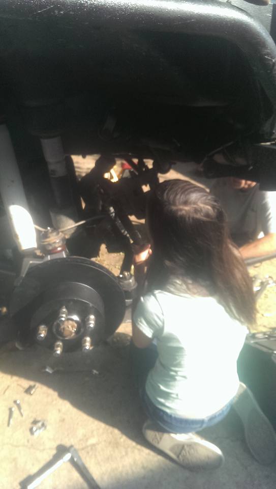

Got a good start done today. Got radius arms dropped and inspected, greased and reinstalled. Found a bent bolt causing radius arms to hit each other on one side and repaired. Got factory control arm mounts cut away better, should prevent another noise. Popped out and pressed in new upper axle bushing. Most important repair of the day was cracked exhaust manifold got replaced with a Banks revolver header. Tried the JY but they were all cracked and didn't want to waste more time driving around trying. Got a couple welds to take care of, emergency brake cables and a few odds and ends to finish up tomorrow.

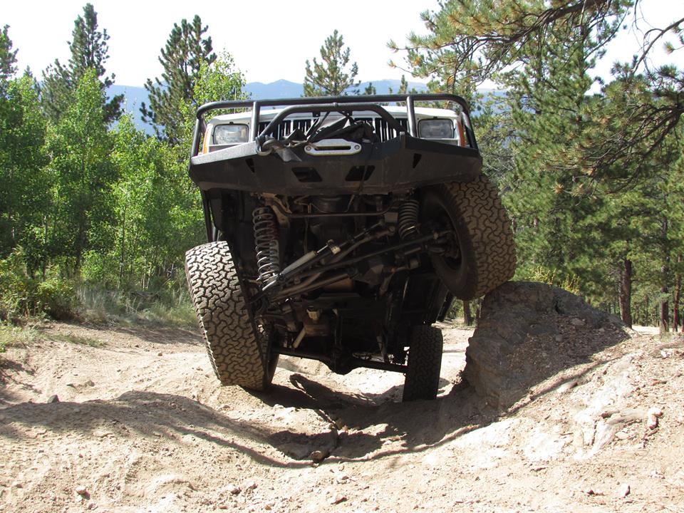

Managed to get last weeks list done and get truck out to the trails for a wonderful family day. Truck did good, but brake calipers were not releasing making a bit of brake noise. Got the brakes pulled apart and found drivers side caliper wobbling around. Bolts were snugged all the way down. Determined steering knuckle needed to be replaced along with calipers and pads. Ordered steering knuckles to do both sides. Picked up brake rotors and calipers and ordered in my pads, should arrive today and be back together. While looking at passenger side wheel bearing assembly was leaking so went ahead and replaced it with a Moog (3 year warranty). Brother managed to get it all done after work yesterday, I am truly blessed to have such a great brother. When pads arrive just have to load/mount calipers and bleed the brakes.

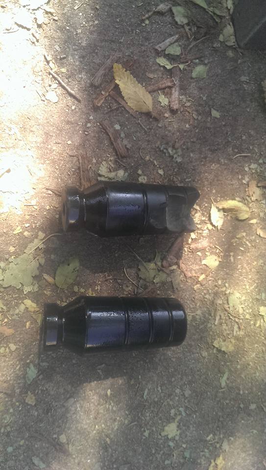

Had to straighten driver side upper bump stop mount after detonating bump stop from axle not hitting flat. Adjusted axle to sit properly and replaced bump stop bushing last weekend. Pads installed and brakes bled. Might be changing pitman arm length for more ideal steering geometry but truck is an alignment away from another test trip...I think
no more stacking blocks to make jack tall enough to lift truck

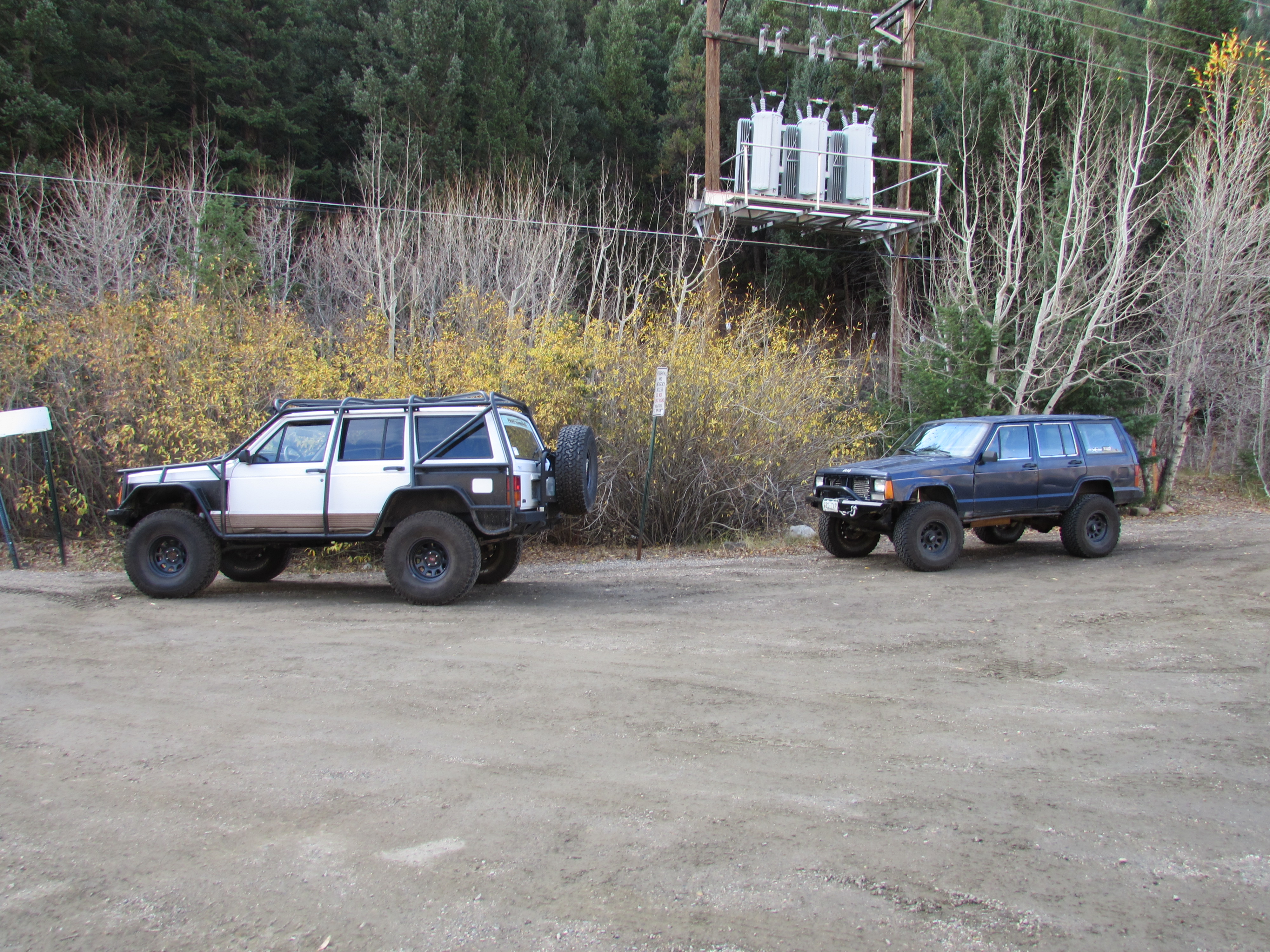

We got out to one of our favorite trails last weekend. Had to winch up the first obstacle because front locker was not working and almost tested the cage already. Repaired the broken wire and completed the rest of the trail. Got a little video of the day, if you go to my youtube page there is also a short clip of 1st obstacle that is not edited for sound.

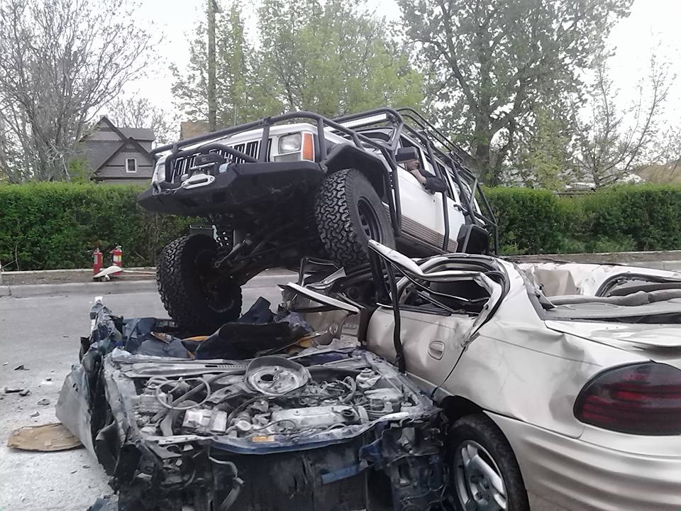

Not much being done on build but going to have a few things to take care of after last weekends urban crawling. Lowest point of tire lifts 28.5 inches with limiter straps set as they are. Pretty good but should be able to safely allow a couple more inches with a little coil noise. Blew out rear shock driving off the cars. About a month ago wife traded in her Jeep for a new Ram 1500, something we can tow with. XJ might become a trailer queen instead of getting a diesel now.

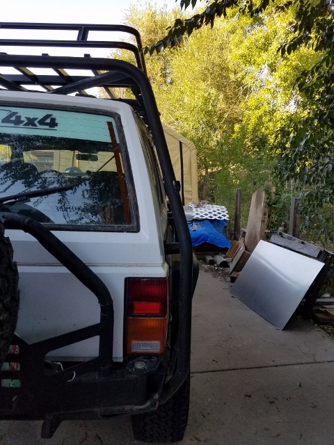

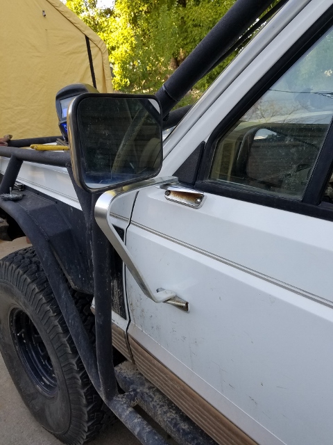

Old Feb 22, 2017 | 10:39 AM
  #60
xaza's Avatar
Joined: Jul 2011
Posts: 276
Likes: 41
From: Colorado

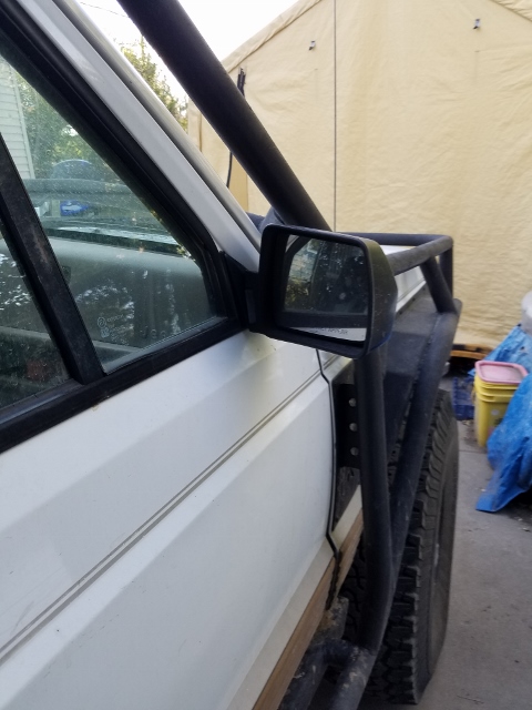

After installing the cage the factory mirrors went from too small to worthless. You either see a bunch of cage or they are turned out too far to be much help. Found the solution to this with 94 Ford F250 mirrors. Not sure if the sheet metal would hold up to a nut/washer and didn't want to have to fumble around inside these tiny doors. Decided to make some backing plates with some nuts and strip metal. To cover the corner of door where factory mirror was removed I picked up extra covers for the inside of the doors at JY. I trimmed them and attached using weatherstripping glue. I will go back and make a solid bead on the outside with clear silicone to make sure there are no spots for water to sneak inside the door. I have not driven it yet but the mirrors look great. They moved out far enough to see around the cage with a good angle yet in tight for trails. They have maintained their ability to fold in and tuck nicely into the line of protection the cage offers. The glass is much larger and does not taper down at the outer edge like the factory mirrors. Line of sight looks good for pulling trailer now also.
