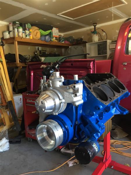

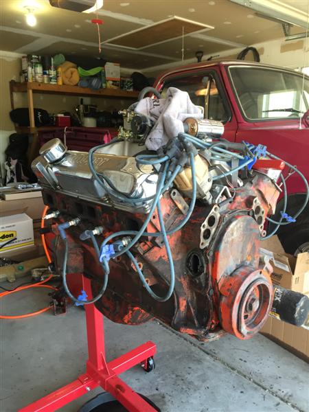

Here are some of the pics. This is my first build and I wasn't planning on going this far but couldn't help it.
This is what it looked like when I got it
The engine bay needs some attention
It has some nice features but still got some work to do
Here is the new water pump which is where all this started
The serpentine belt pulleys look cool

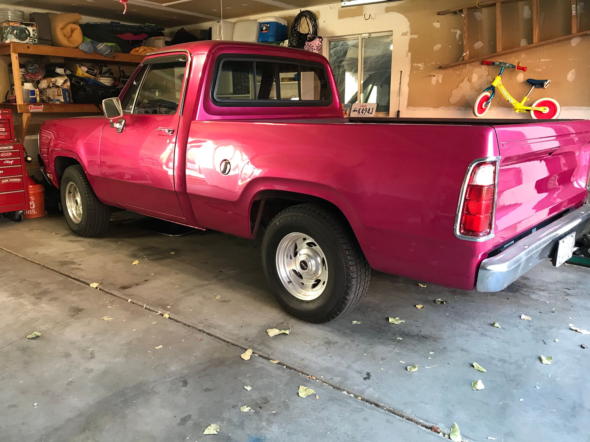

It’s been a while since I posted any updates but here it goes.
After I got the engine all finished and put in the truck I broke in the cam and saw water coming out the exhaust. While trying to find the cause, changing head gaskets and having the heads checked at a different machine shop, I ended up hydro locking a cylinder and bending a rod so I had to start all over. I had the heads checked a 3rd time by another shop and they said the intake runner was cracked probably from over grinding when it was ported. The guy that did the porting just worked out of his garage so there wasn’t a lot I could do about it. I ended up buying a set of closed chamber iron heads that were CNC ported with 2.14/1.81 valves and decked a little to get me to 9.5-1 compression. I did end up using the whiplash cam from Hughes engine and this thing is a beast now. I just lowered the back end 2” and am getting the new differential ready to drop in this spring. I’m thinking of lowering it a little more but I’m not sure on that yet. Right now I’m just going to enjoy it while I do a few little things.

Thanks, it goes pretty good right now. It pulls really hard at a roll but from the line it just makes tire smoke. Next up are a few things with the suspension.
