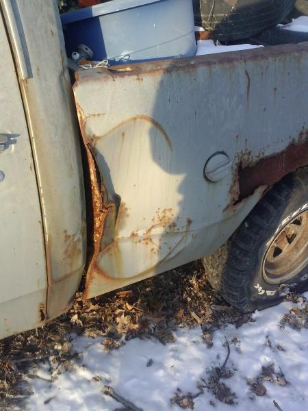

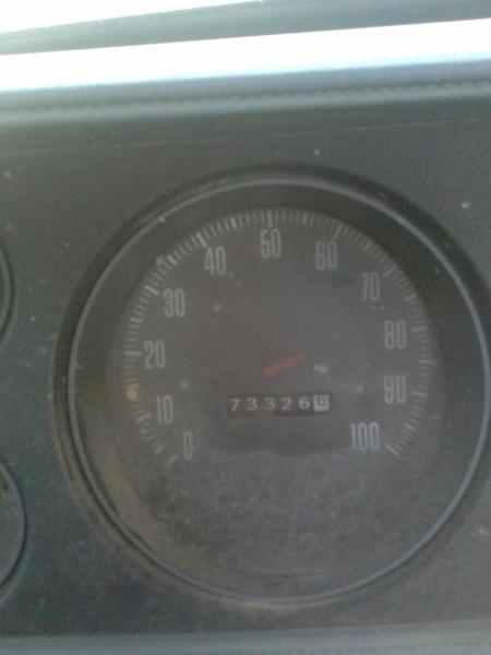

The snow and cold hasnt let up around here so i havent gotten an opportunity to get out and do much with the truck, but heres some pics of it.

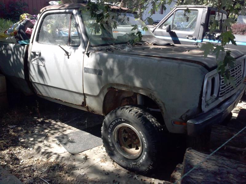

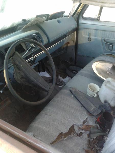

ok, so i finally got a chance to go out and take some more pics of the truck where she sits today. Its going to be going in the garage that its sitting next to right now as soon as i get some stuff situated with my trailers(i own a trailer park so i have maintenance materials everywhere) My plan with this truck is to strip it to bare frame and sandblast and recoat the frame, run all new updated lines and wiring, rebuild or possibly upgrade the axles with lockers, rebuild the 400 and give it a little stumble in its rumble, the body is still way up in the air about what treatment its getting because there isnt a straight body panel on the truck so it may get a steel flatbed, but im thinking sour apple green with matte baldwin stripes. Snorkel kit, twin stacks, 36" boggers or 37" humvee tires, interior side will be buckets, but havent decided whether i want 5 point harness racing seats or not. Then once its all done a 1 1/2 chromoly tube exocage.
