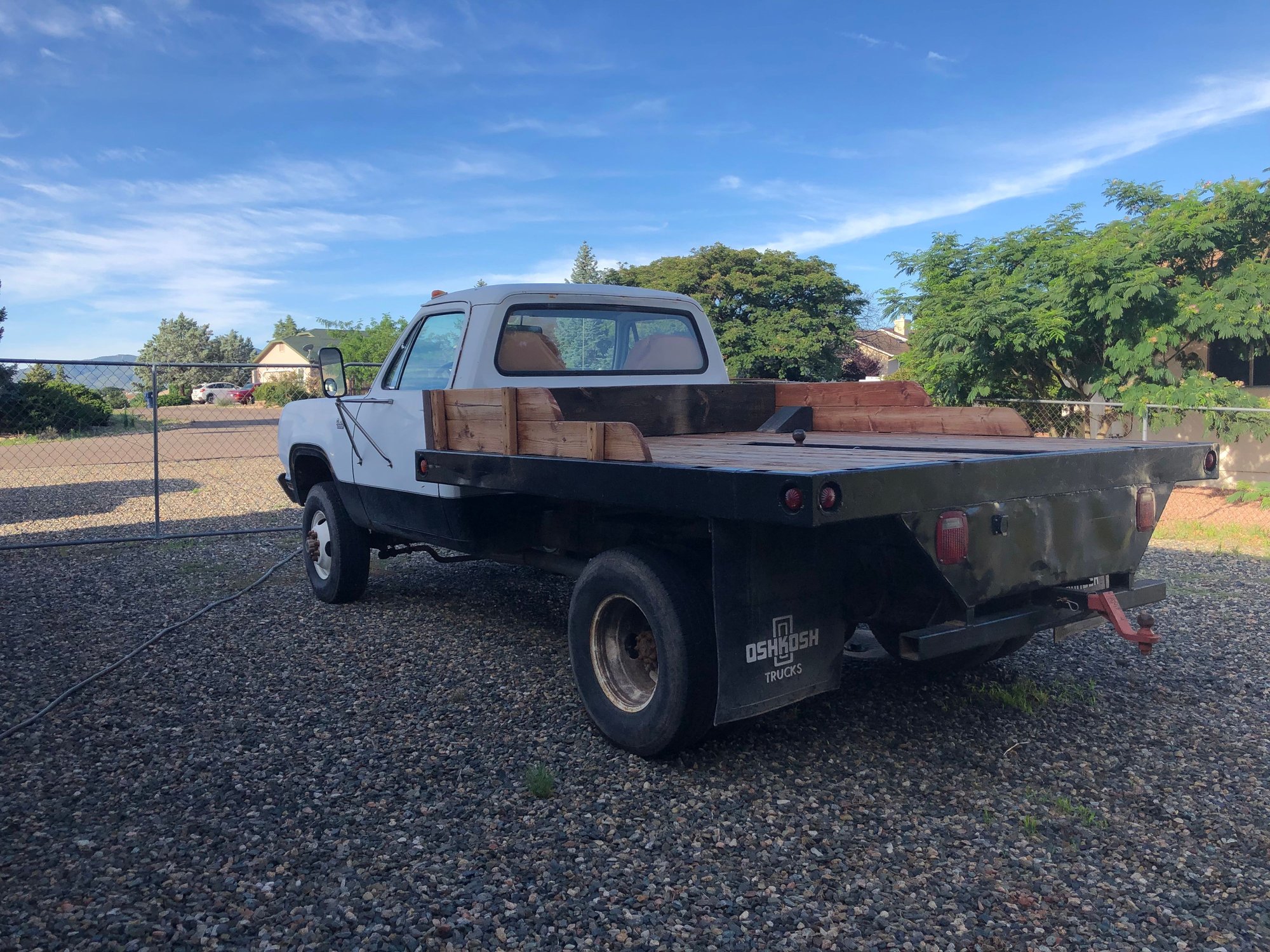

Hello everyone. Just picked up my newest project: 1974 W300 4x4 dually flatbed, 33k original miles, automatic, 360. Intend to use it to pull my horse trailer. It's a beast! I know nothing about Mopar trucks. I have always had classic Chevy's so this is all new to me.
It runs great but needs some attention. The left door regulator binds about 3" from the top. I can close it if I push the window up by hand while cranking. The same door also does not close completely. It will catch but I need to push it hard to completely close it. Any suggestions?
Supposedly was used by a fire department. Any way to check into this?
I'm not afraid to roll up sleeves and get to work. Thanks in advance for any help you can provide.

Welcome to the forum. Nice truck. Looks like its set up to pull any kind of trailer you have. Maybe a little lube will help the window work. Check the door hinge pins for wear. Lift up on the rear of the door when its open and to check for worn pins.

Welcome.... Fine looking work truck !!!!!!

ooooooooooo, that thing IS a beast! nice nice! how do you like the 360 so far?

Super nice, saw that picture and had a flash back of my '92 DOUG E, that flat bed looks the same as the one I built. Had a rock knock off the top of the second D so he became the punk rapper truck DOUG E.
