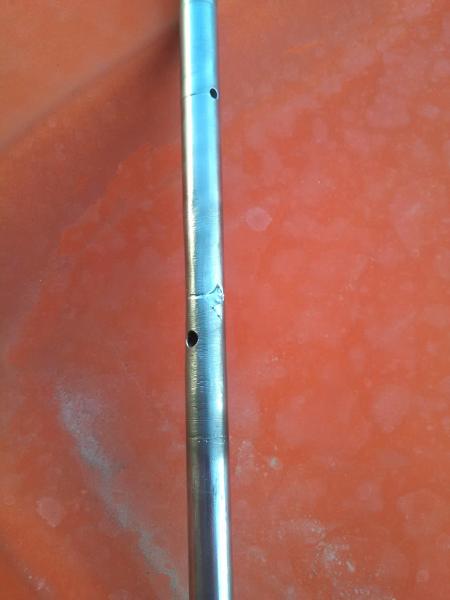

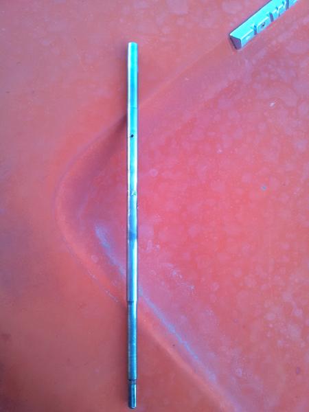

I did not want to buy a Mopar priming tool so i built one out of an old distributor and distributor drive shaft. After welding the two pieces together i ground down the high spots with a table grinder. Then used a metal file and filed it smooth by hand.
