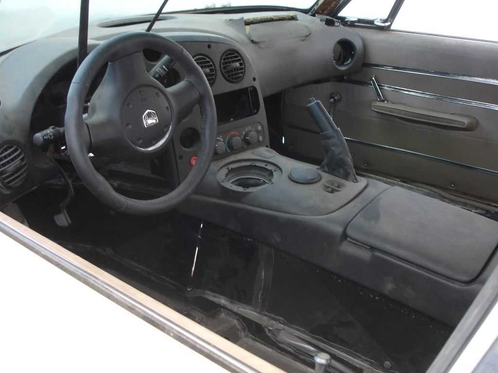

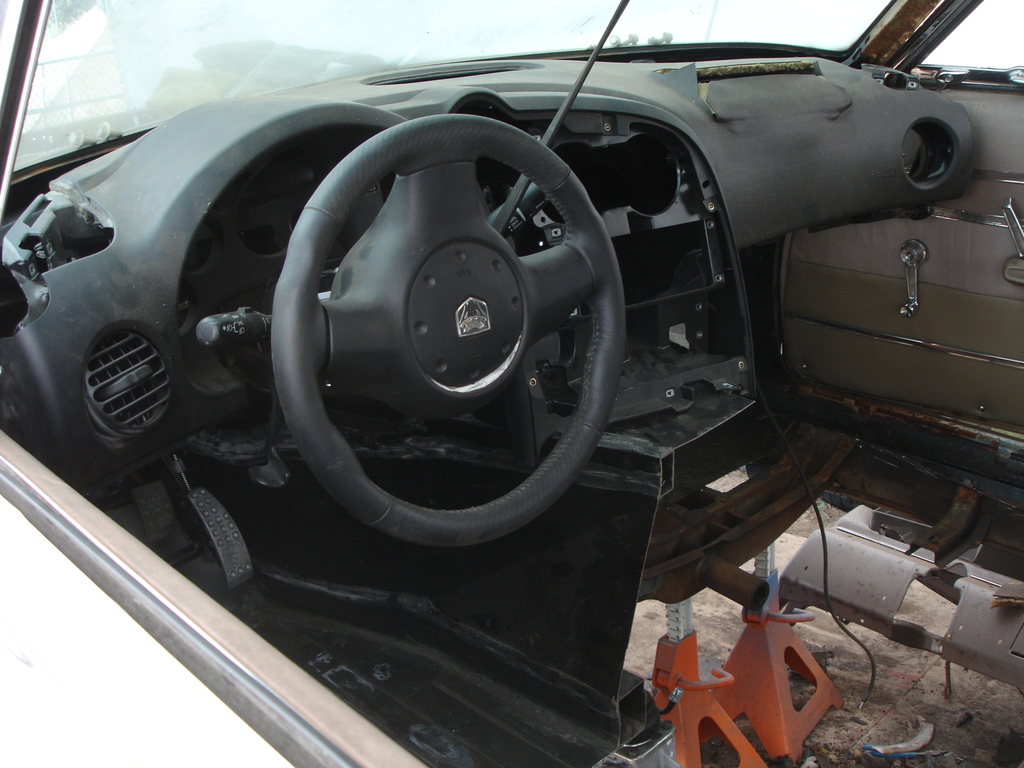

The Viper dash width is a good match. It's the mounting it that's the problem due to what is inside of it...the structures and ducts. I'm leaning towards what you see....a blending of both. If I go this way then I'll paint the hard parts black or cover for a match.

I can solve the issue with the AC and heater later. I need to fab up a rough tunnel so I can get the motor back far enough.

Since I will have to trim the Viper dash panel if I am to use it.............I will go ahead and cut it so we can see how it fits. The distance between the front axles and firewall is very different in these two cars........thus the fitment issues.

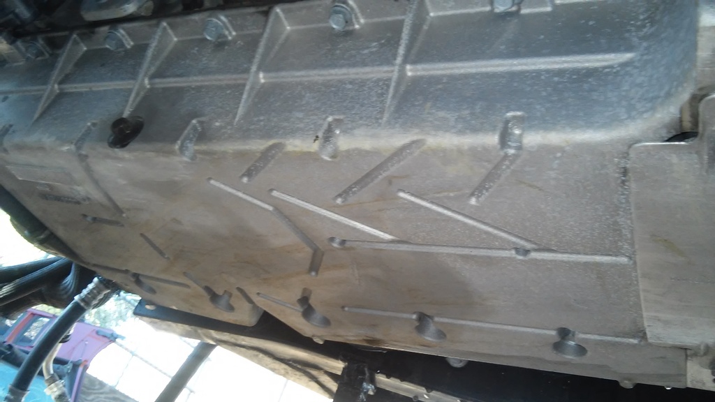

The custom front suspension may be here pretty soon. Be awesome to get the engine mounts located. One really great thing is...........the oil pan is FLAT.

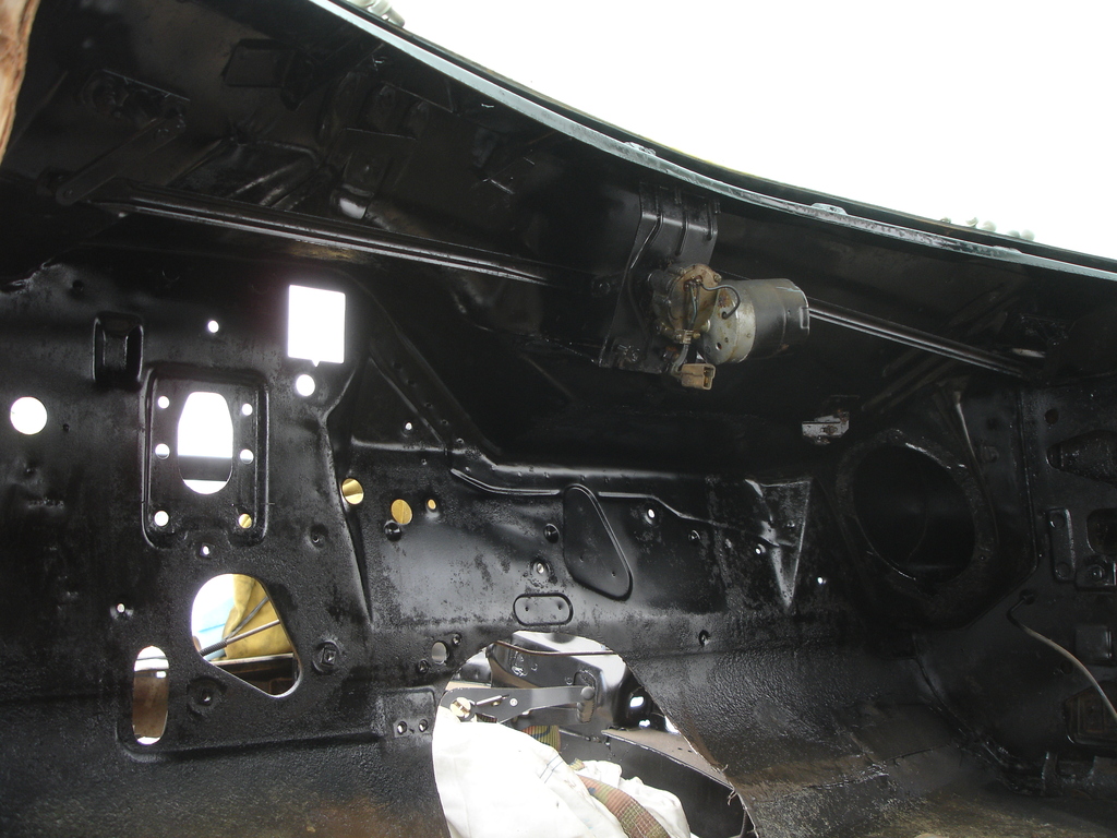

While neither as glamorous nor exciting as an aluminum V10, custom suspension nor leather seats..........it is important.
I could not drive around knowing that there was a rusty firewall just above my feet and if I decide to sell the car someday my diligence will be demonstrated to potential buyers.

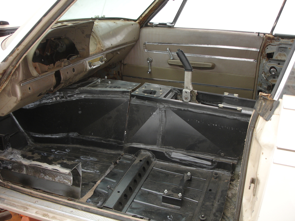

Had some time to mock up the pedals and steering with some of the floor..........what a pain
When I look at these pics I remember why I don't like to show work in progress
This whole project is like putting a square peg in a round hole, but I'll win............

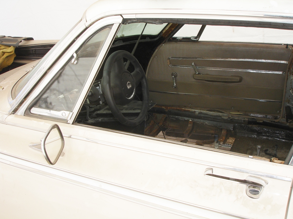

I do believe I'll end up sitting a little more rear than I wanted, but it is a compromise.
We can see here the wheel is in a decent location, but maybe 3-4 inches or so rear from where I had hoped.

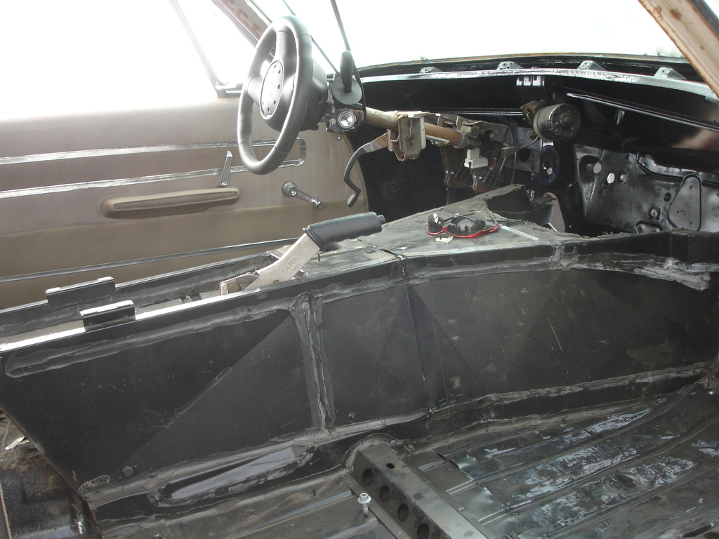

Did some cutting, modding and welding.
I have the main structure of the front tack welded in place.
