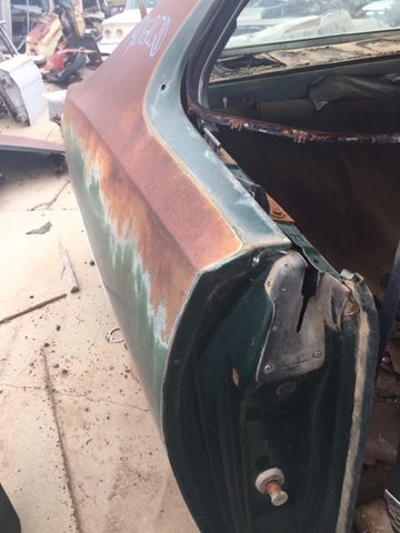

Ok gentlemen this is where i need some assistance. I have located the parts I need from a salvage lot down south(Desert Valley Auto Parts). The car I am working on is a Rally car and the parts they have are from an SE. Is there any difference in the quarter panel?

Not in the parts you need.
Even with the SE opera windows, the vinyl roof covers std rear windows cutouts.
Archer
Old Aug 7, 2019 | 06:00 PM
The top half of the quarter and door are different on yours than a SE car but you may be able to make them work.

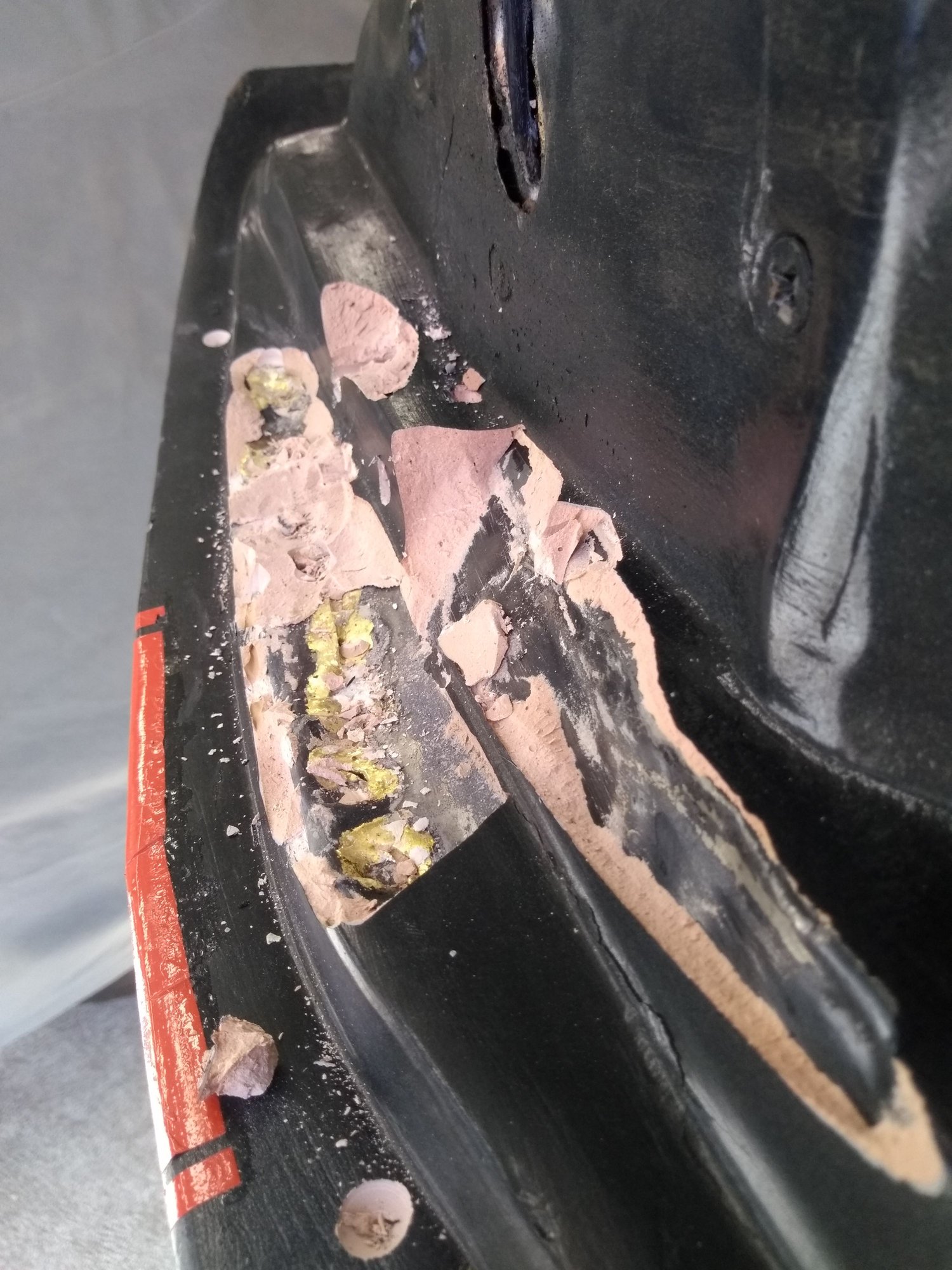

While Im waiting on the sheet-metal to arrive I decided to just slowly take the car apart. I knew the door was junk, but god damn this mudwork is kind of impressive!

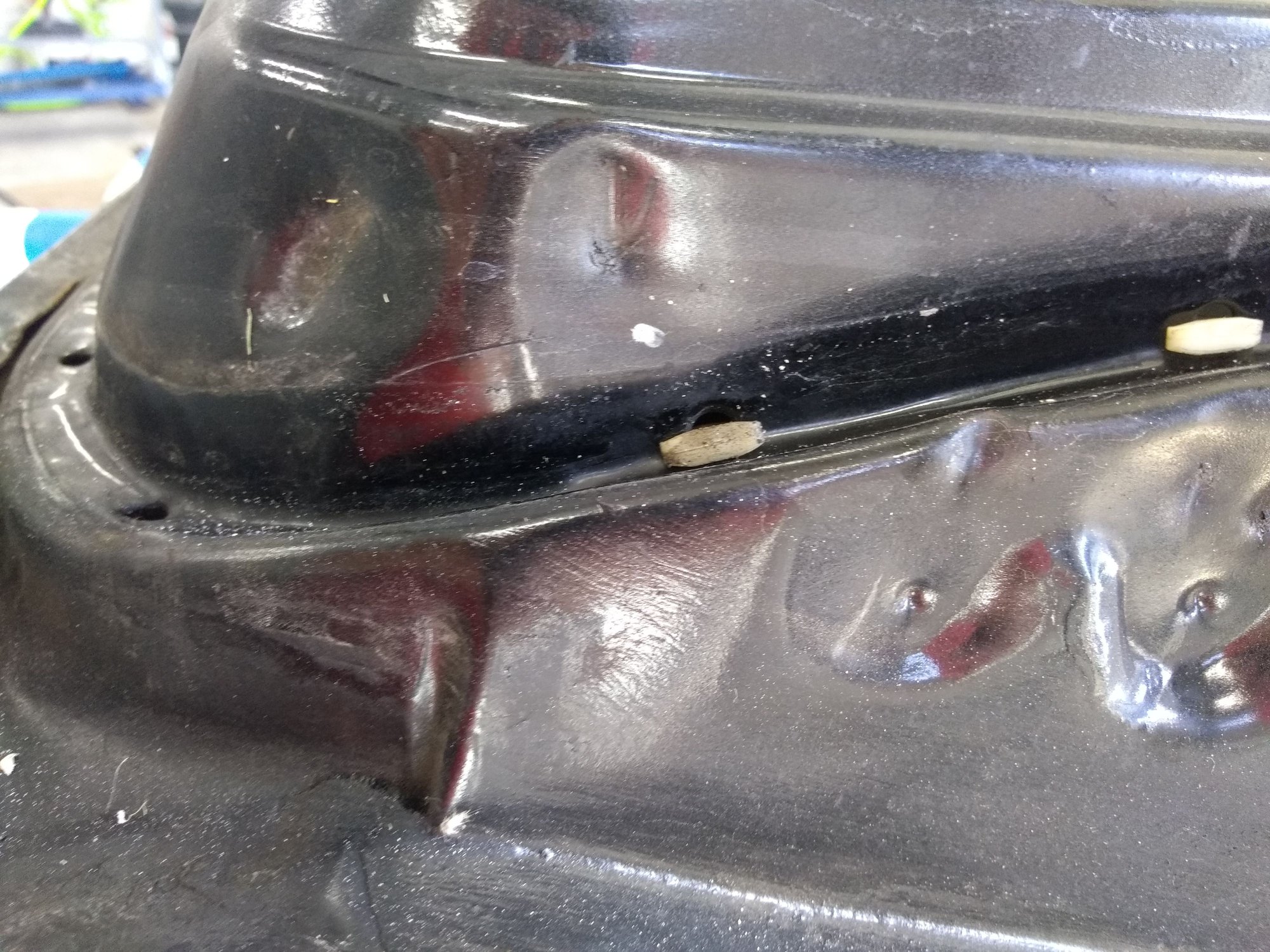

Just keeps getting better and better.
Old Oct 1, 2019 | 09:01 AM
You will be able to push some of that out after you get the quarter off.

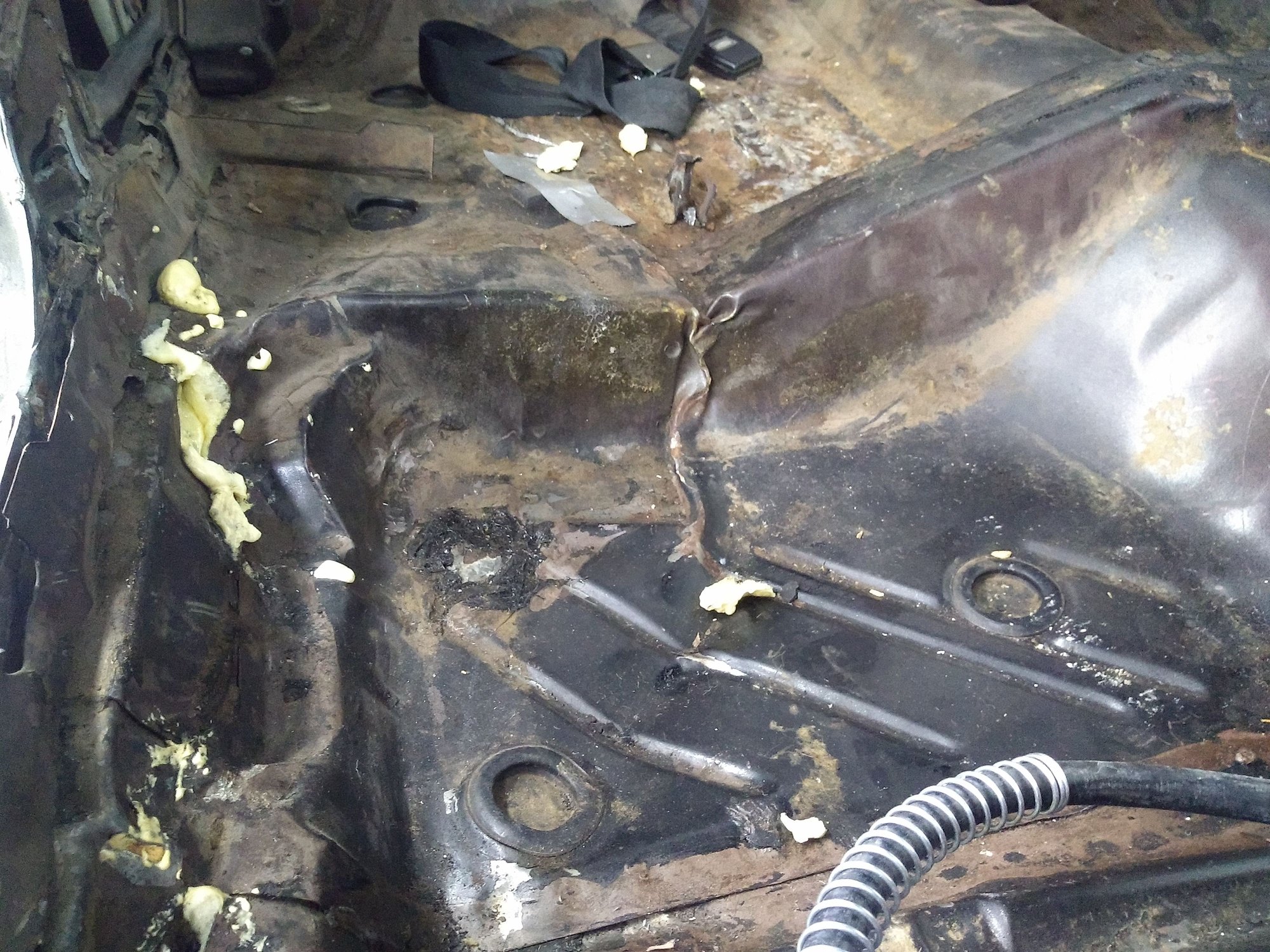

What I am looking for though is possibly some information on measuring points on the frame. My fear is that this car will have to go on a rack and be slightly pulled. The hit was pretty low in the rocker and the roof doesnt appear to be buckled. but there was some major butchery on this repair as you can see in the images.

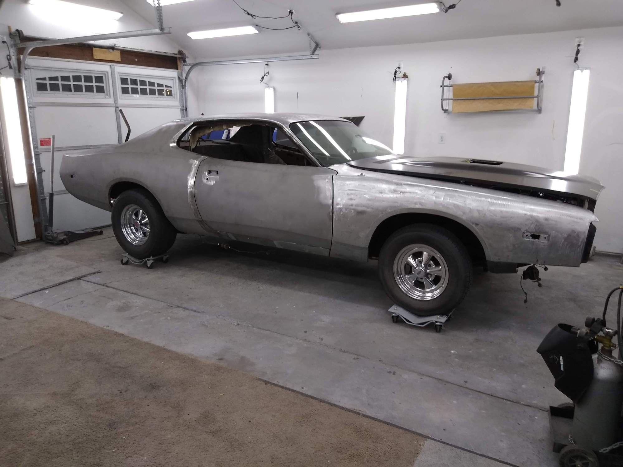

Guess I toss another update in here. Got the donor parts all installed. Had to send the decklid out for blasting(curious if anything will be left). Got the red of the car stripped and ready for bodywork to begin. Found some cancer on the drivers side lower quarter. Searching for parts now.
Cannot believe nobody makes patch panels for these cars yet.

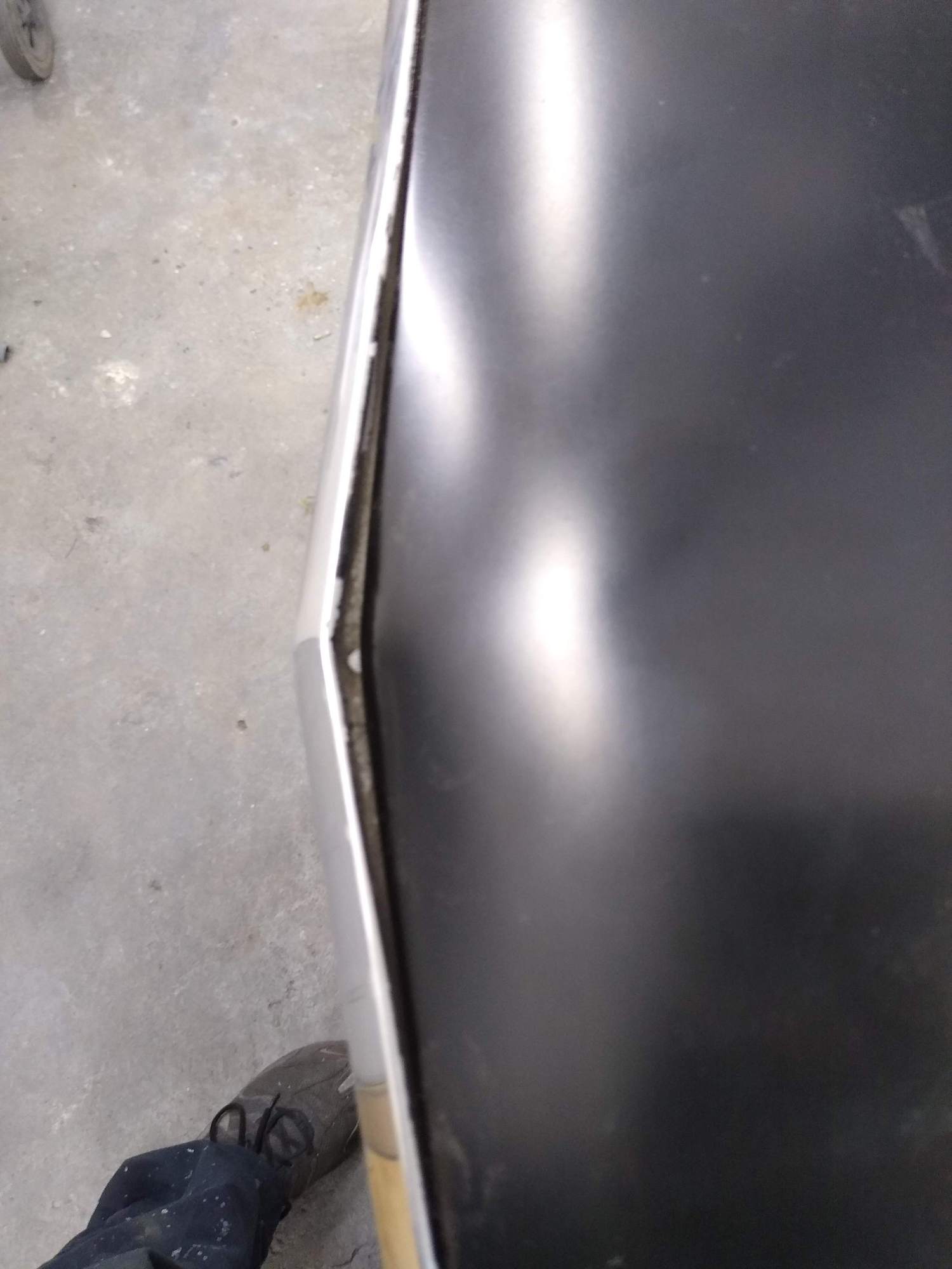

The hood on this car is an AMD piece, the molding fits terrible but I checked it on a stock hood I have in the garage and it fit the same?? Is that just how these are?
