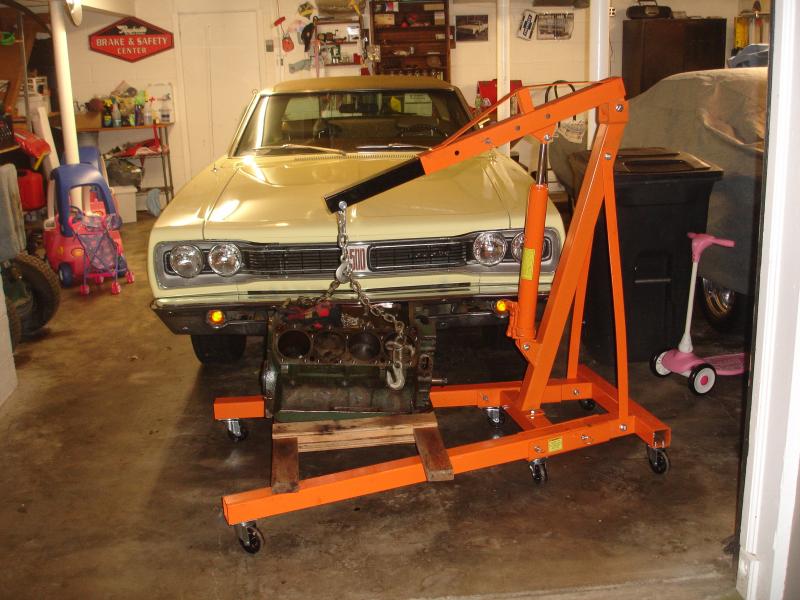

Off to the machine shop
I have taken it as far as I can. R and L speed shopin Westwood NJ will take it from here. I'll keep you posted on the progress..

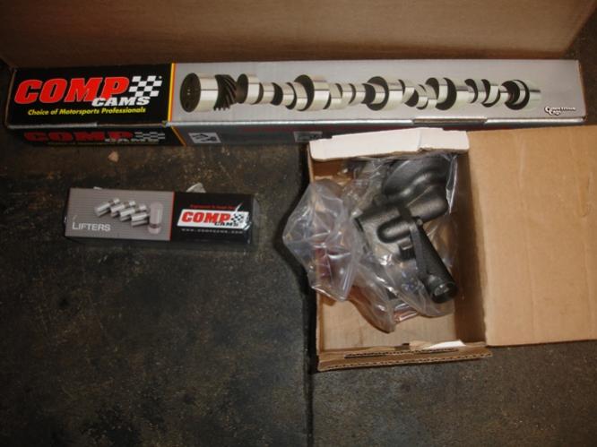

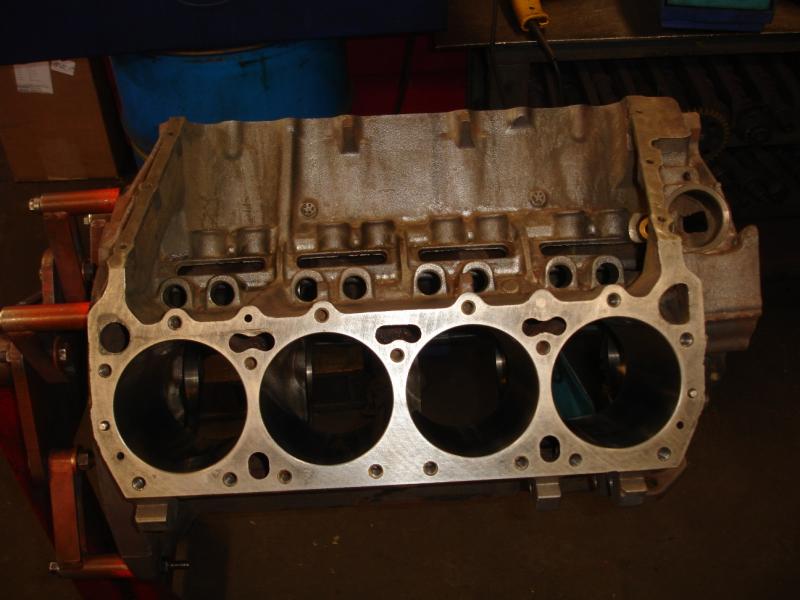

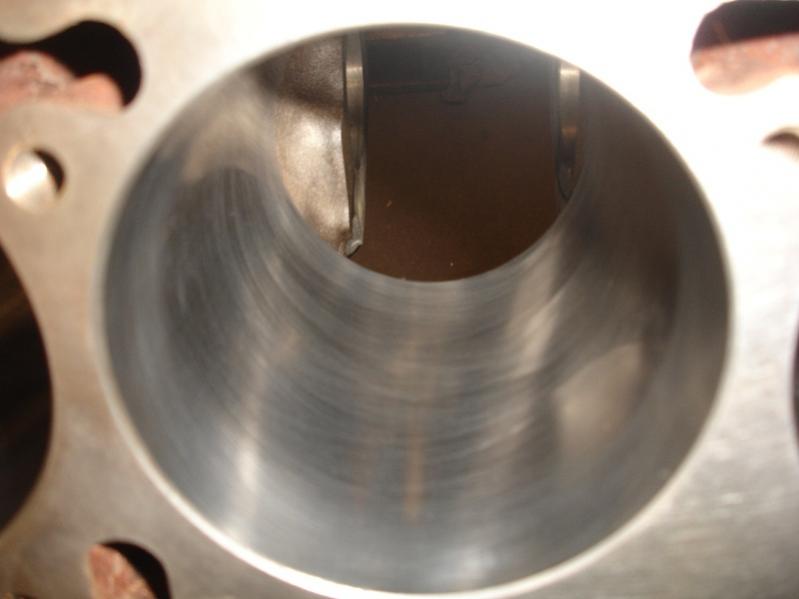

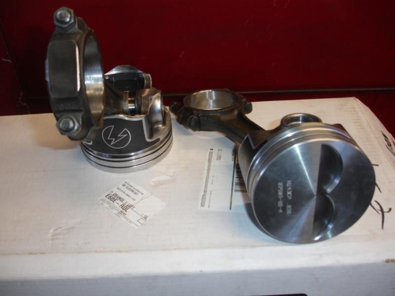

a 440 is re-born
Bored .30 over.

Here she is. 440 bored.30 over with 9.5 compression. Eddy RPM Performer Heads,Intake and Eddy carb. Crane cam slightly larger than stock. I was able to use original crank, piston rods, lifters, water pump housing. Also got some pld school Cal custom valve covers...
