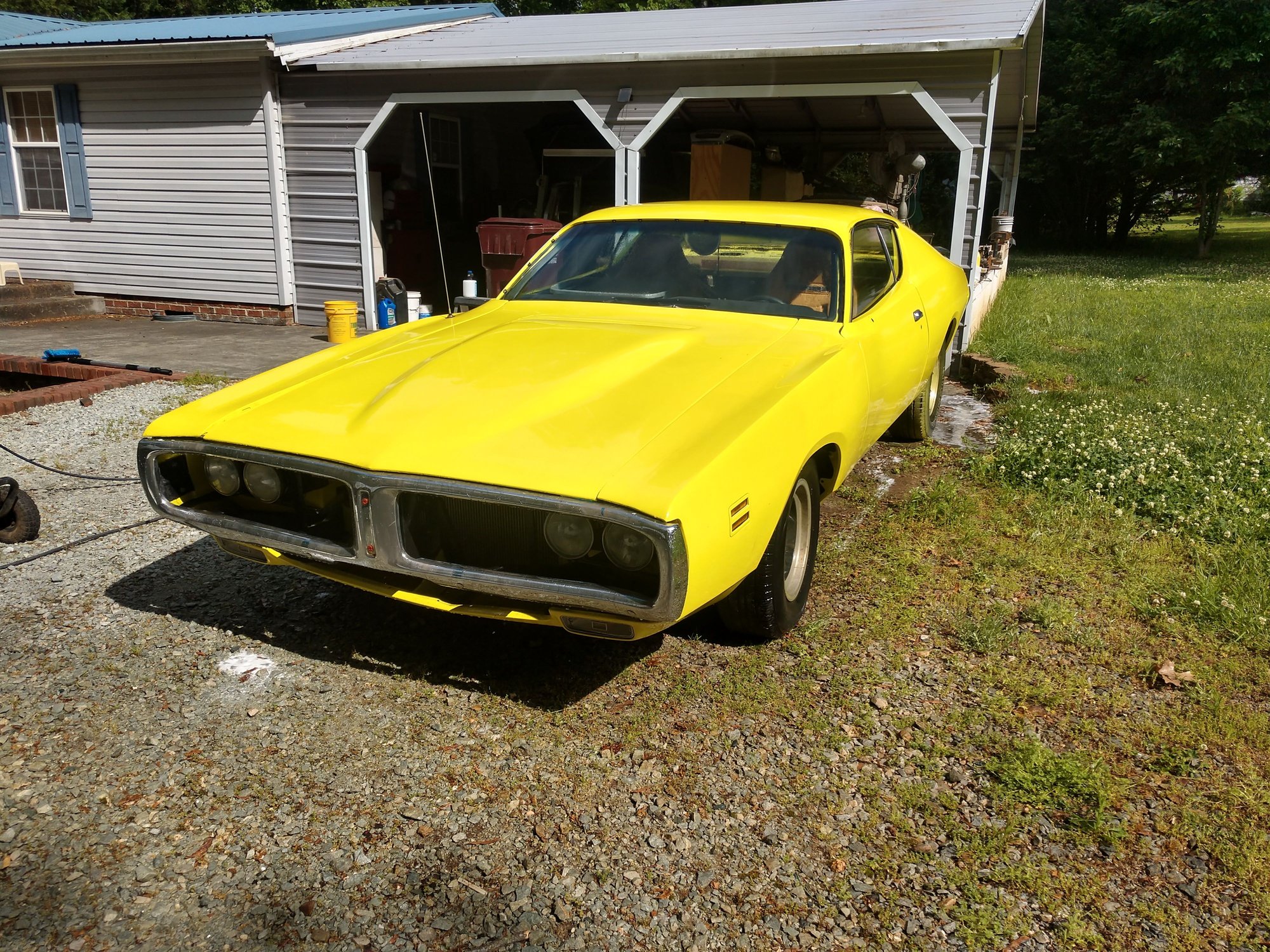

Update on the charger. I trailer ed it a few times to a friend's house. He has a lift. I have tags and Insurance on it so I am driving it now. I had bought a new set of wheels and was saving up to buy some new tires before mounting them. One day while I was driving my old roller tires gave up. I had to buy some used tires quickly. I mounted them to the new wheels. They are too small, but I think that they look a lot better than what I had on there. I have been dialing in the timing and crab. Also working on the interior. I was taking my neighbor out for a spin when my heater core gave up the goods. Had to remove that and replace it. There is a vibration that comes in at around 55 to 65 mph. I got to track that down. The cam for the wiper motor broke off both tabs, so a quick repair with the tig welder sorted that out. I have taken my dog for a few rides, I think she likes it!
