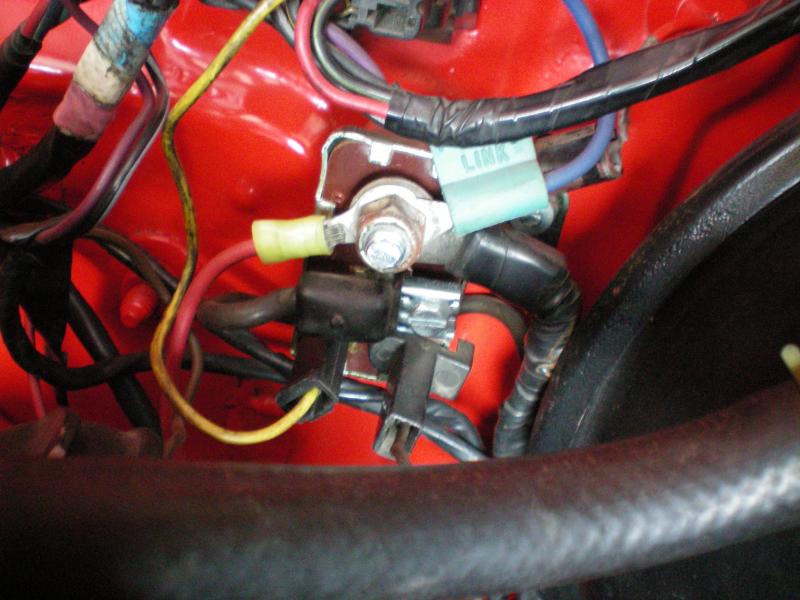

3 READ CAREFULLY. You can "simulate" using the key by a SPECIFIC method. This will not easily work on a stick car with a clutch safety switch. Make sure the trans is in park/ neutral, and remove the YELLOW "push on" wire at the starter relay. Use a clip lead (or screwdriver) to jump between the exposed push on terminal and the "big stud"
In the photo below, I'm referring to one of the two top terminals. One of them (they are interchangeable) has the yellow wire, the other goes to the neutral safety switch. You can switch them around. Older stick cars only have ONE of these terminals, the other being permanently grounded.
You must jumper the yellow connected relay terminal to the big battery stud at the bottom in the photo

We charged it up and it ran!
But, Roadrunner440, I convinced my dad to get a voltmeter,
and I struggled to find the part you were referencing at..
Is this the same part??
and ground?? is this a cable, or what.
Sorry to be kinda stupid about this, but I really wanna figure this out!
Thank you Roadrunner!

That's it!!! That relay does two jobs
(Somehow I missed what year your car is.........and stick or automatic)
1 On automatic cars, the brown wire in the bottom of your photo goes to the neutral safety switch and grounds one end of the relay coil in park or neutral
On 70/ later stick cars which have a clutch safety switch, the same wire does the same thing -- you must depress the clutch
On earlier stick cars, the brown wire is missing, and that terminal is soldered to the relay case, permanently grounding it
The yellow wire comes from the ignition switch and is hot in "start" activating the relay
2 The second thing these relays do is lighten the load on the ignition switch. The ignition switch fires the relay, and the relay fires the starter solenoid.
Notice the two largest "bare" connectors. The "big stud" is battery, the "square" screw goes to the solenoid. If you jumper across those two with a screwdriver, the starter should crank.

I get it now,
The Car is a 69' , and has 727 torqueflite.
The Yellow cable goes to the ignition switch (Key)
The Brown goes to a Neutral Saftey switch.(No starting in gears other than Park and Neutral)
Thanks for the jumping trick. That may come in handy in a situation!
AWESOME...
Problem Averted, and a small lesson wiring.
Thank you, Roadrunner440!
