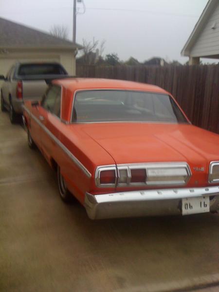

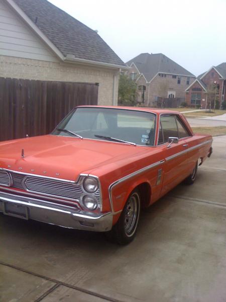

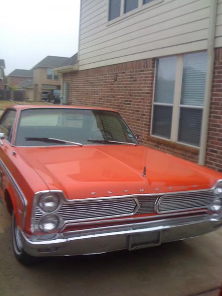

1966 Plymouth Fury III 2-Door hard Top 383 Commando
The Body is kinda straight and most everything is there. I actually was able to drive it about 60 miles to home. I dont think its going into 3rd. gear and there is a loud hummmm coming from the rear end.
Started disassembly this week end.
I am looking for advice on where to find interior parts such as seat covers, door panels, and Dash Pad. Also wondering what size wheels and tires will fit under this thing.
I was thinking 15" rims possibly 8" wide in front and 10" wide in back.
The car has 14" wheels on it now and I think someone removed some leafsprings, Its setting really low in the rear and I only see 3 Leafs.
Looking forward to the car and this Forum.

Check to see if the kick-down linkage from the carb to trans is stuck, that can keep it out of third. Humming from the rear is probably an axle shaft bearing. Get it checked out before the tube is toast. For a manual on CD see>> http://www.detroitironis.com/ interior stuff >> http://legendaryautointeriors.com/ properly set ride height should allow 15's, might have to soften the inner lip of the wheel opening a bit. For other odd bits try http://www.texasacres.com/ Nice car!
