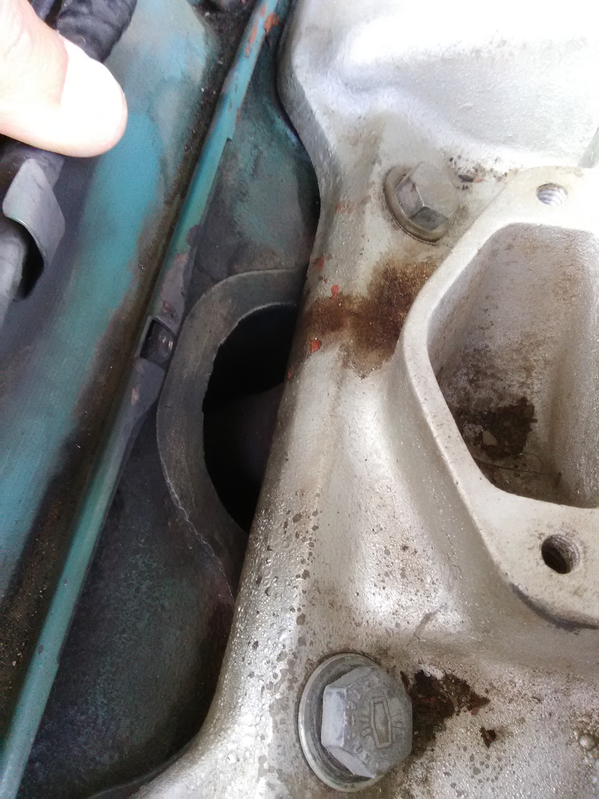

One big question, it gets vapor lock after running for a while, I noticed right under the fuel line on the side of the head/intake that it is BLOWING AIR OUT??? Never seen air come out, only in? The guy I got it from said it's probably missing a baffle.

If it is a correct 66 motor there should be casting numbers on the left side of the block. If it is a newer 383 68+ they should be on the right side of the motor.
as for the air coming out If I am correct there should be a block off plate on the top. I think that was to heat up the intake temp for cold starts If I am Correct.

Well here it is. You can see where the air is coming out
Attached Thumbnails 66 fury vip-img_20170526_155939.jpg   66 fury vip-img_20170526_155946.jpg

No.. Air dose not come out of that hole... Heat yes.. Air No...
Unless the gasket is bad.

Yeah there's a decent amount of air blowing out. Enough to blow starter fluid right back at me.
That's how I noticed it, was checking the intake seals and it sprayed me back LOL
I just rebuilt the carb. Anybody ever see one double stamped? I can't make out any #s because there's an old stamp, and some newer looking numbers right on top of each other. It's a Carter AFB 4bbl
I'm pulling the intake right now, got new valley pan and intake seals. Anybody know the torque specs for the intake? Not finding it online and my manual hasn't arrived yet

No more air leaking out I need to get the heads & intake decked, it's pretty rough around that port. Little bit of rtv sealed her up though. HUGE power gain
