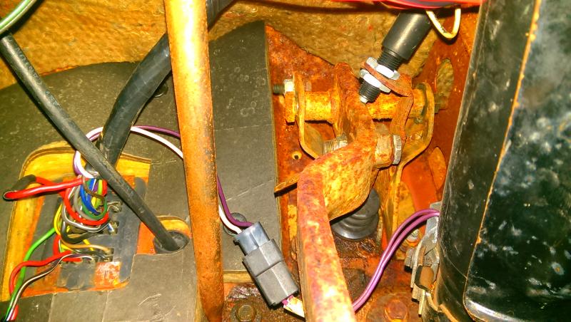

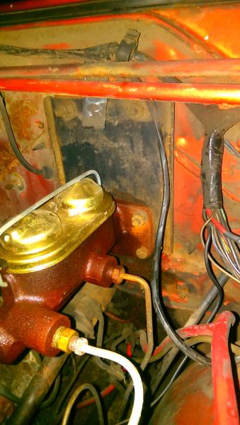

It took only about 2h to get it up and running again, and drove it the short way home. breaks were non existent, and I see I have a bad master cylinder leaking into the floorboard.
Now comes the question,
It was sold with the power brake option, but I assume in the past the booster went out and someone replaced it with a manual master cylinder.
There is a large plate that the manual master cylinder bolts to, and that bolts to the firewall.
Am I able to get a new master cylinder/booster and just replace it? or were there more changes done to convert to a manual master?
I can get the manual master prety cheap, but would prefer the power option since it came with it, and it's just a good idea imo.
I have attached pics of the pedal attachment to the master and the master/firewall plate.
Any advice would be helpful.

Sounds like you have the 4 piston caliper brakes (same as in my 68 Imperials). You need the booster.
My guess is that the booster will bolt right on, along with a longer pushrod.

First off if you install power brakes The re enforcement plate needs to be removed. The plate is bolted to the firewall & the booster uses those holes in the firewall for mounting. If contemplating a big cam ? keep the manual brakes

for 1967 the 383 had two compression ratios, 2 bbl 9.2 / 4 bbl 10.0. the 383 and 440 mild engine cam had a 256 intake degree, 260 ext degree. the HP 440, 268 intake degree, 284 ext degree. the mild 383-440 intake valve lift .425, ext .435 inch. HP 440 only intake .450, ext .458 inch. the cam in other years might be different. the Chrysler 1967 brake system says that the drum and disc brake master cyl are different. on the midland ross brake , power, shows a small plate, they call it a filter, between the booster and master cyl.. it has 4 holes. that goes between the booster and master cyl. 4 bolts. there is bigger thinner plate that goes between the booster and firewall. the push rod going to the master cyl has a length set to .929-.910 from the plate. they also had a bendix it is much bigger and not many made. hope that helps.

A rebuilt Booster will always come with the linkage. The problem you will have is most shops will want to rebuild yours. Almost any booster will fit I would check the junkyard for a late 70's Cordova, Charger booster should fit... KEEP the old parts !!!!

I'll be doing all the mechanical/Bodywork(minus the rechroming)/paint, so "shops" won't be an issue, I was just seeing lot about the pedal assembly being changed online. but didn't look like my assembly. so if there are no changes there, I'll be putting one of these in her in a couple months once I work out the rest of the daily cruiser bugs.
