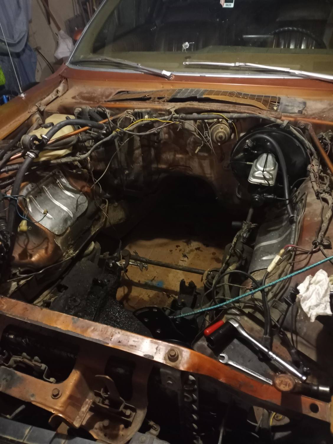

It's been quite a while since I (or anyone else) has posted on the F-Body page. I've been busy working on my 360 build, and boy have I been having fun. I ended up pulling an 88 360 out of an 89 W250 as my core. I bored it 30 over and had ARP rod bolts put in (I picked up a set of flat top pistons to go with it). The cam is the closest thing I could get to the 68 340 4 speed cam, with 218/224 lift at .050 and .462/.470 lift (It's a hydraulic flat tappet). With my 65 cc performer rpm heads, it comes out to around 9.5:1 compression. I don't have an intake yet (I bought a china one that was so trash I had to send it back), but I picked up an Eddy AVS2 (#1906) 650 CFM to top it off. Now I just need to get a flywheel (or I might end up using a quiktime balancing plate), TTI headers, and some small stuff. I pulled the 318 and tranny out of my Aspen last night, so I'm getting close to being able to hear my 360 purr.
Anybody know where I can buy a reproduction AVS style fuel line?
(I'm sorry I don't have pictures on here right now, I'll add some later)

Pictures- here ya go
