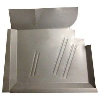

This is the floor pan that C2C offers and it seems to be identical to all the other floor pans I'm finding for sale everywhere else. Completely missing the pedal section. I've tried hitting up the fancy 300 Club to see if they have any leads....and the correct patch panel was made by a company called " R Car Fabs" but I haven't found any information on them online. I have considered contacting the guys that did the restoration on the car above and see if they remember the information for that vendor or not
