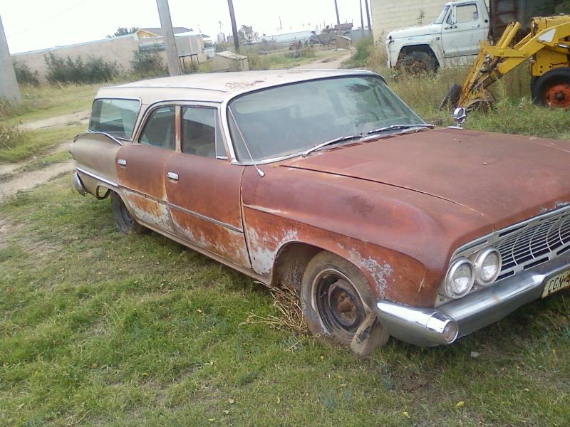

Like to see some pix of that wagon!

heres some. and one of my 40 dodge
Attached Thumbnails 61 station wagon help!!-sspx0005.jpg   61 station wagon help!!-sspx0006.jpg   61 station wagon help!!-sspx0007.jpg   61 station wagon help!!-sspx0008.jpg

Nice rides both. I would run that wagon just the way it sits, body wise. Maybe wide white walls on red rims with chrome lugs and a center cap. I like the patina and being as you are building a rat rod I guess you do too. You should be able to find a 318 or better a 360 with the trans for little investment. There is a company called Imperial Conversions that sell kits to install newer trannies in cable shift cars wich is what the push button is. I hear they are not cheap. Being as you already have the cable shift trans you might be able to fab up something to make it work. maybe swap valve bodies(?) In any event good luck and have fun.
