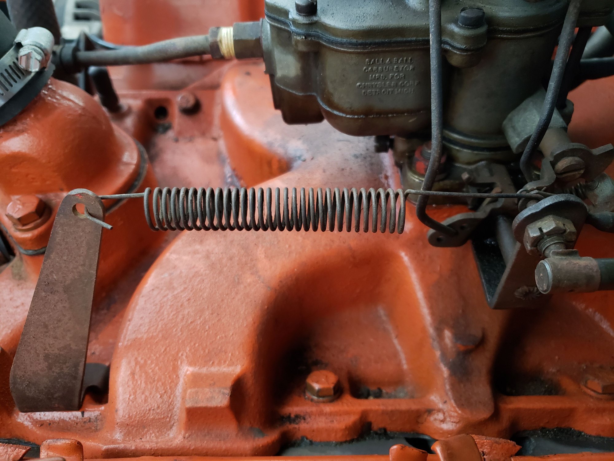

OK as far as I can tell hoses seem to be tight and secure.
The linkages on it appear to be loose, unless its supposed to be like that. And the return spring looks a bit stretch out. (Unless it's like that)
Old Dec 31, 2018 | 12:59 PM
In the first photo.... See the step cam with the notches.. when the engine is hot, it should not be on the step cam. Use your finger and move the step cam off the screw and see if it Idles where it is supposed too?
