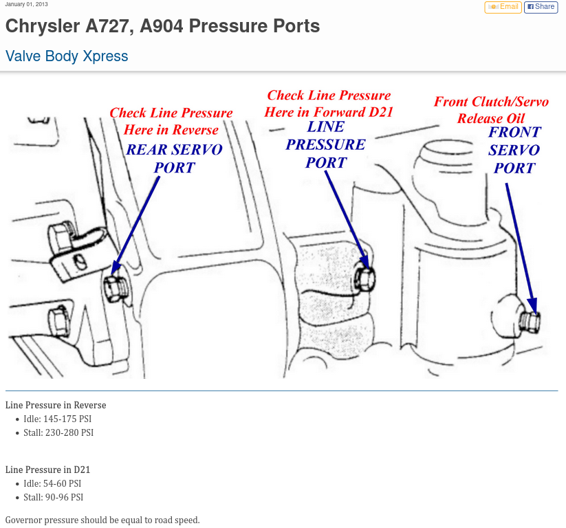

Well, not being a transmission man all I can offer is guesses.
However, the fact it doesn't do anything now makes me think of issues like Low fluid, clogged filter or a bad pump.
There are test ports for checking pressures on the TorqueFlite but, I've never done that. Maybe worth checking before dropping the pan for inspection and losing your fluid.
Maybe someone else here can offer more advice.
https://www.sonnax.com/tech_resource...pressure-ports
