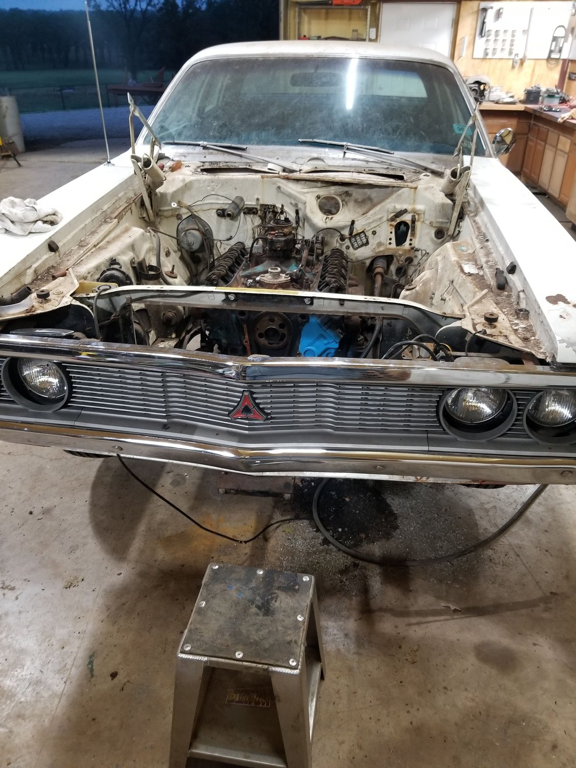

I have recently inherited my Granny's car. The insurance card has it as a 1970 Dodge Coronet. It has been kept under a tarp for the last 20 plus years. I'm looking to do a few upgrades but leave it as original as I possibly can. The car only has 30000 original miles.
The one thing that I am having trouble finding is a one piece oil pan gasket. If anyone knows of anywhere I could purchase one that would be a great help.
May look like it needs alot of work but if i was covered for over 20 years i would too. Lol

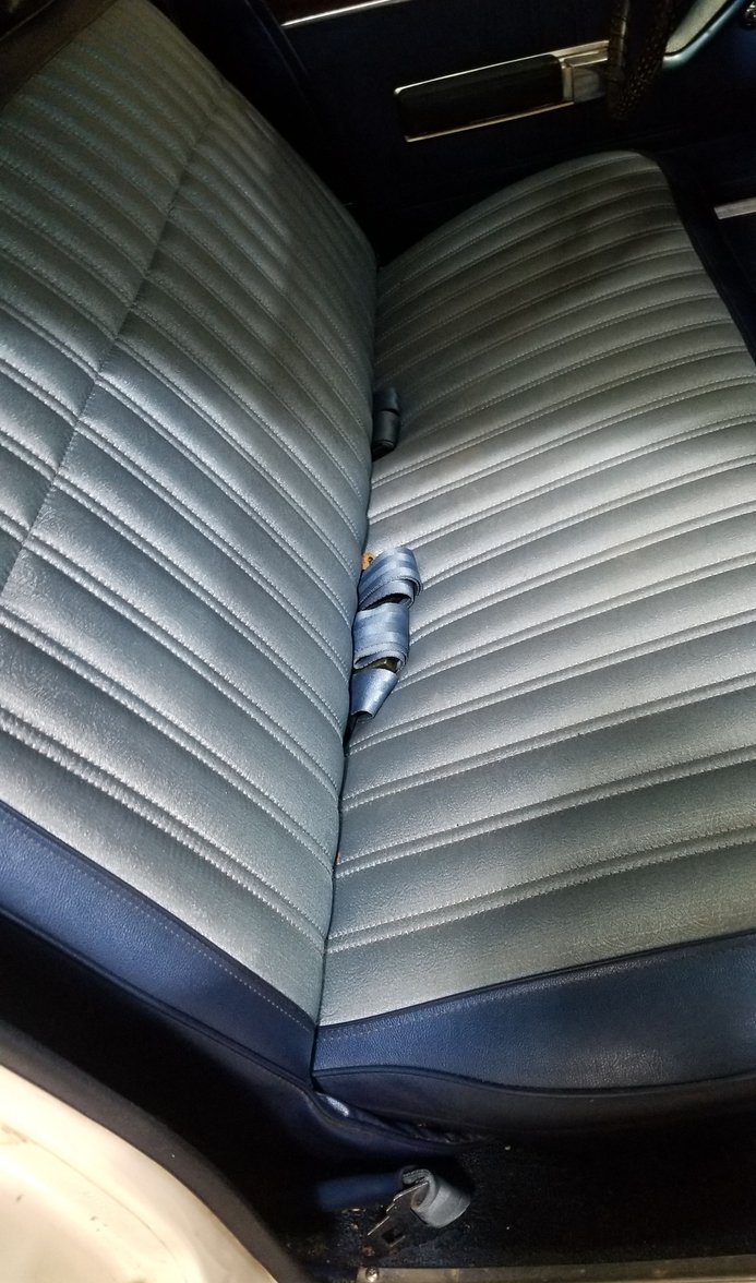

This interior is the best i have ever seen for a car of this age.

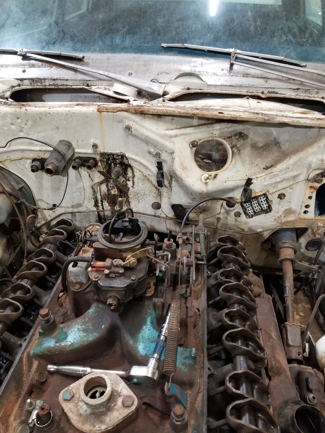

Can anyone tell me what that black box is on the firewall? Is it something to do with the ignition?

Voltage regulator.
The white thing to the right is the ballast resistor. aka burn box.

They are readily available, but while you're at it, you might want to replace/upgrade the whole ignition system (ECU,ballast resistor, distributor and harness). The Mopar electronic kits are pretty inexpensive and also readily available.

Well... every day I do a little more washing on this car as it sits on stands. It coming clean and getting a shine to it. Can't wait till it is all done and I get to drive it.

Ita staying the original color. As is. All I'm doing is the engine compartment and the motor and accessories.

Getting her ready to pull the motor and paint engine bay. Its a slow process but it is going to be a great reward when its done
If I'm not mistaken, that's the ignition module.

No, it's the voltage regulator.
The ignition module (ECU) looks like this (ebay photo):
But newer ones may be orange, blue, chrome or gold.
The Orange box is probably the best for the OP's application, unless he wants the retro look.

Yes, you are right. I didn't zoom in to see the two wires. I swapped points to ignition boxes that look just like that, but 4 wires in the 5 pin connector.
