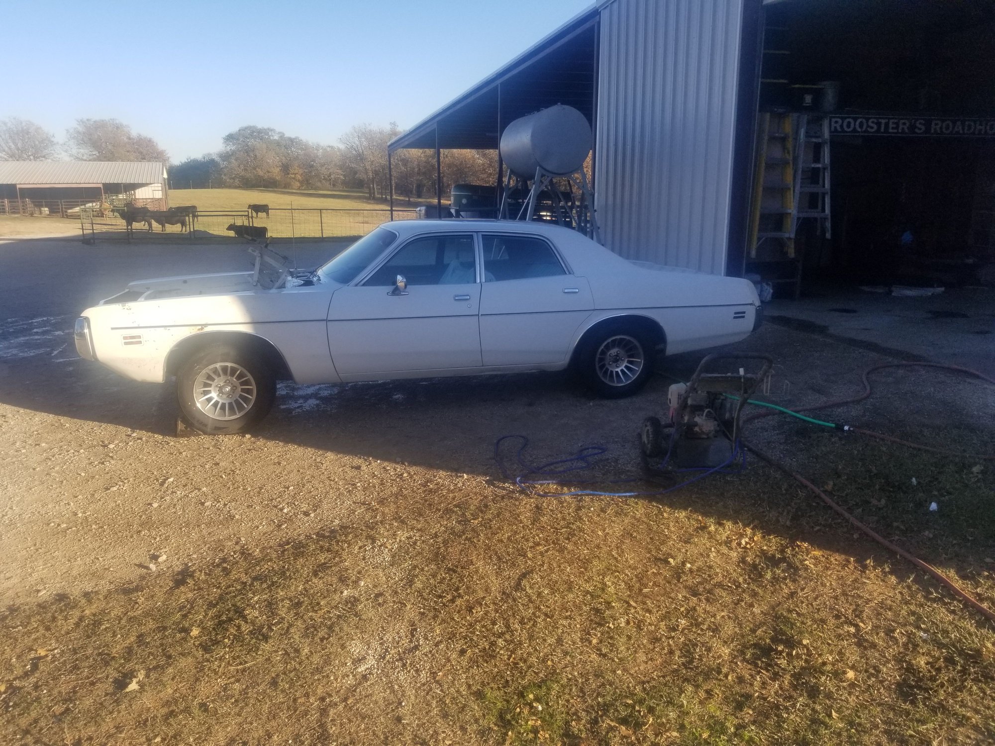

Took her out and give her a bath
Think i might keep the white

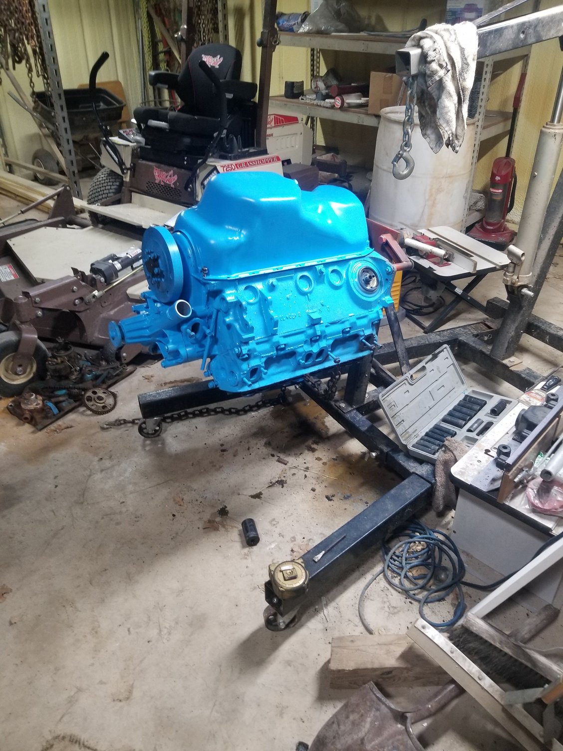

Got the cam kit just about dissolved. Decided to put a little paint on it this evening after working on it.

N -
Ya do know it's upside down, right???
Archer

A,
I thought I'd see if it would fit. Lol.

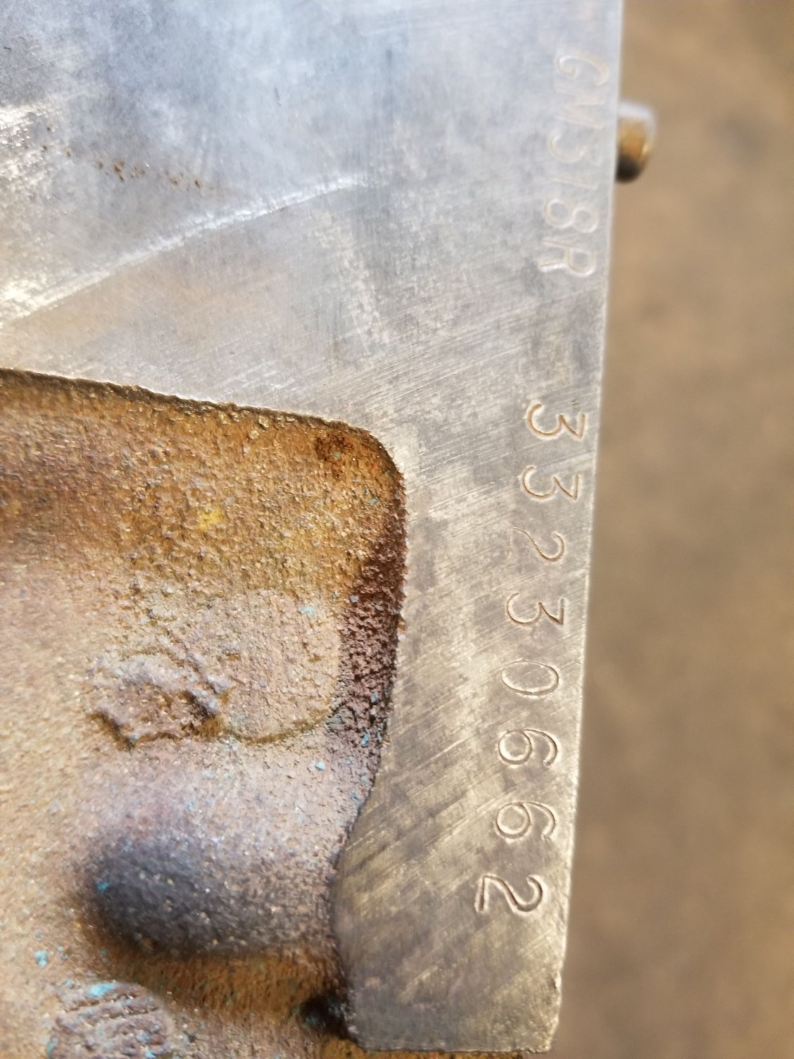

Does anyone know what these numbers mean?
