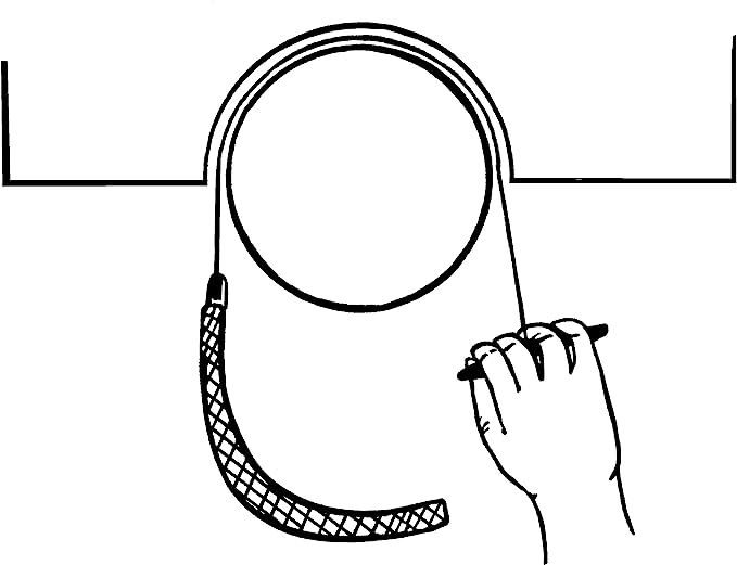

I’ve changed the rear seal on a 383 and a 440 while the engine was in the cars. I replaced with a rope seal using a “sneaky Pete seal tool”. It’s a tedious job. But can be done for sure.
