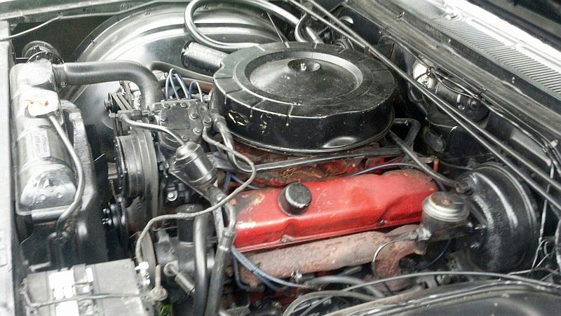

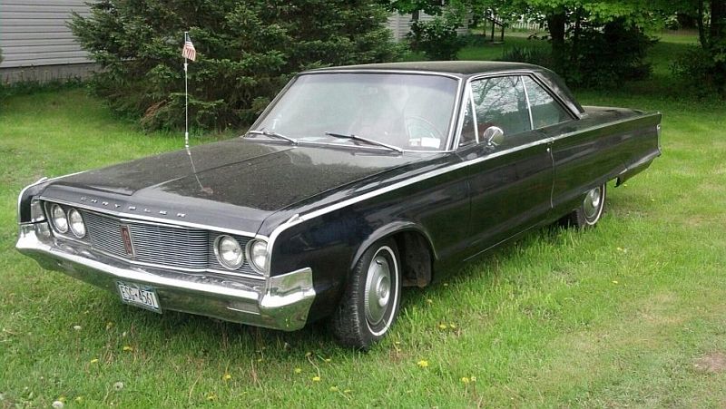

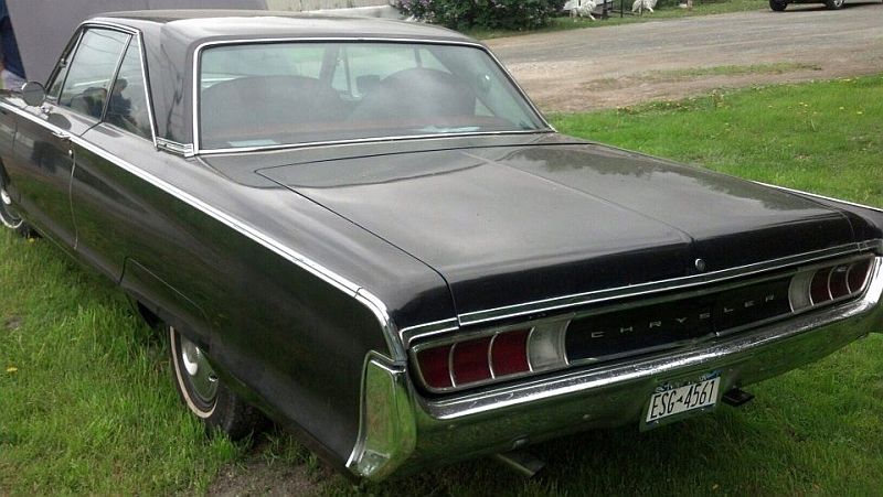

found her on the way home from Vermont last weekend and called the Gentleman up right away and he held the car for us to go look at today, took her for a ride and wow fell in love with her, needs some TLC but she is unmolested with 52K original miles and has been barn kept the last several years, 383 4 barrel with dual exhaust and man what a truck!!!!!

the 1965 383 if stock the 4 bbl is a 10.0 compression. a 2bbl 383 will be a 9.0 compression. if stock. the 4 bbl normaly will get better MPG on the HI way. if it has the Carter carb, if stock i think, DO NOT swap to holley. KEEP THE CARTER. a swap to the chrysler electric ignition is thought to be the best thing to do. if you do all ways have two ballast resisters in your glove box. any time it fails to start just swap the resistor right off. allso if the dist cap has a vent between the center tower and the outside tower plug the vent with JB-weld.
