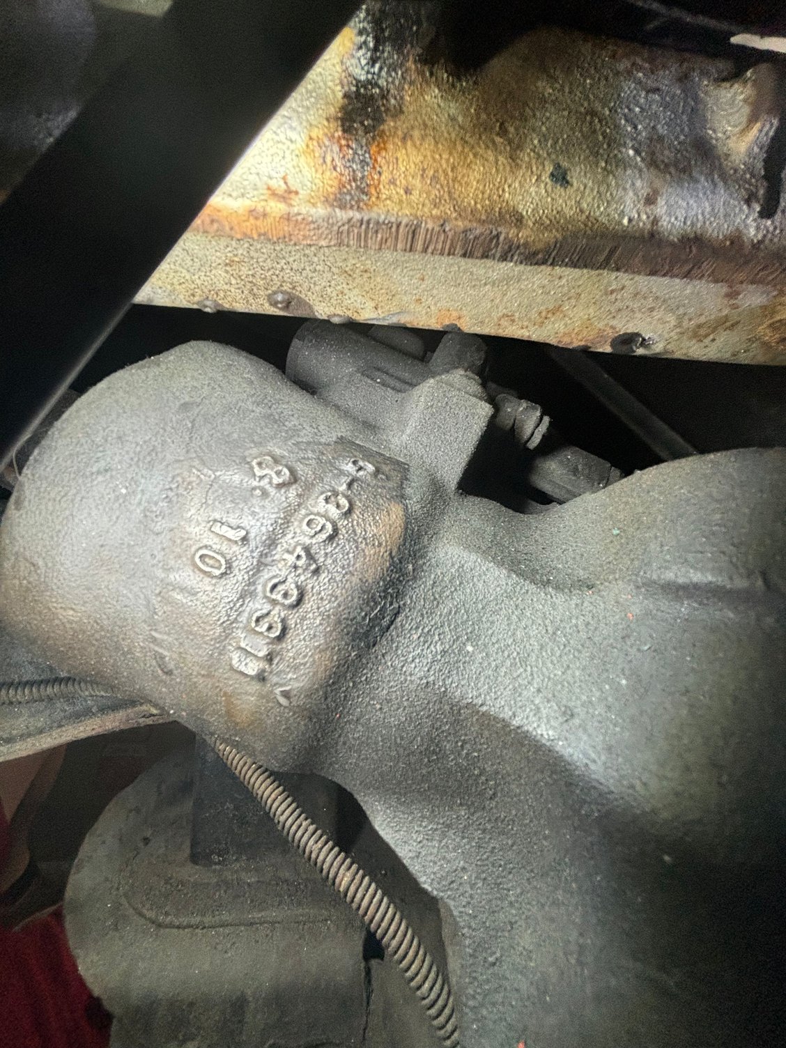

Hello, My name is Ryan and I have a 55 Studebaker Champion that was my dads and was working to redo and I got after he passed. I am limited on information for undercarriage and new to the rebuild game. It has a cammed 340 with 727 Trans 8" Maverick Rear(74-76). Running on 74-80 Plymouth Volaire K Member front end. Im working on the front steering. When removing pitman arm, I cant find the proper one. I was told off a Volare, but order 1 and spline opening is too small. The one on gear box measure at 30mm, I have ordered 2 from Summit both spline holes too small (DPC-PA811050PR, POF-103-10030) I have these Pics of gear box and pitman arm. Anyone know what these are actually for?
Pitman #'s 3815778 and 16372-12 Gear Box G-3643311

The part number is 3815778. It fits 76-80 Volare, Aspen and 77 and later Le Baron. The Moog part is K-7101.
