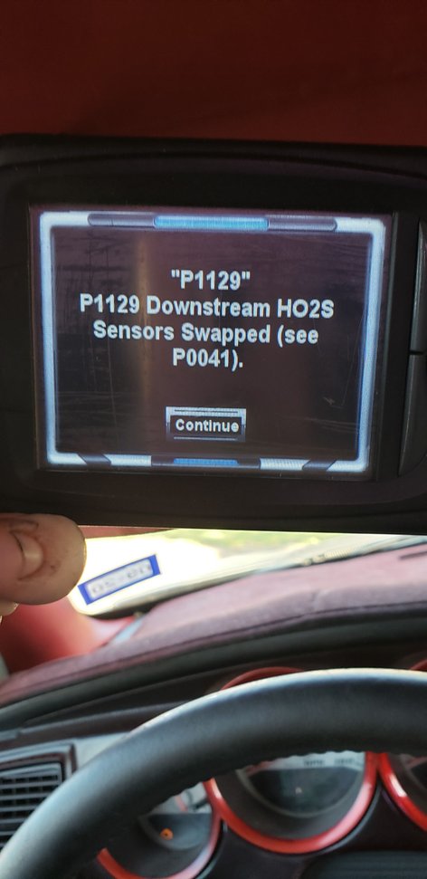

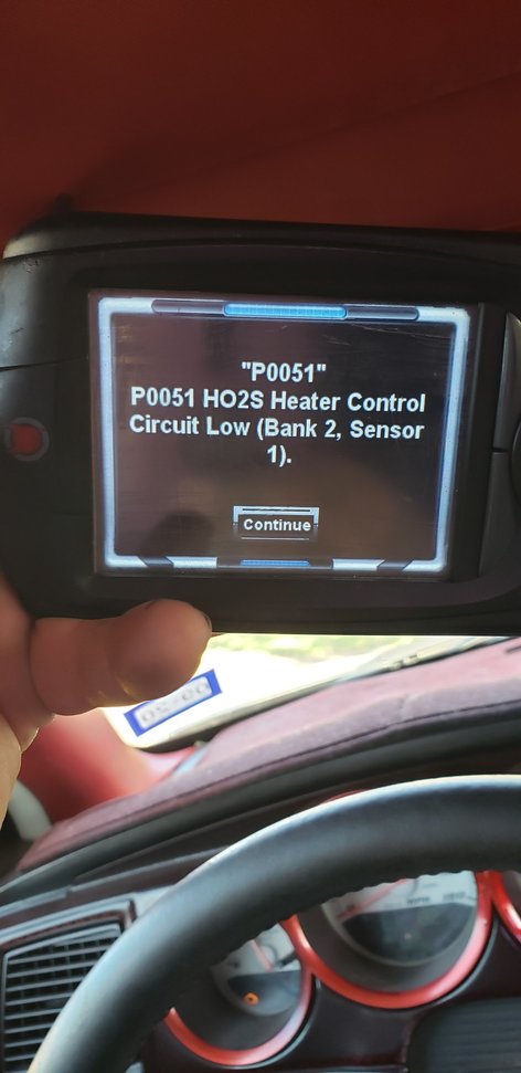

so, we ended up putting another harness in the car hoping it would help cause mine had a lot of unwrapped wires and we found a big exposed wire behind the intake manifold and wasnt sure how bad it really was. So,, got the "new" harness and a new 02 sensor cause my husband insisted. Now I have p1129 and p0051 which are the two 02 sensors in that side and the car is running like crap off and on still. We did some research and the hubby said cause there might be a short its making the car run rich cause it thinks its running lean. Ive done everything and about to do an insurance claim on it 🔥🔥🔥 haha, just kidding. My husband has a high speed Snap On reader where he can reprogram things and tried to fix it with it. No Bueno.
